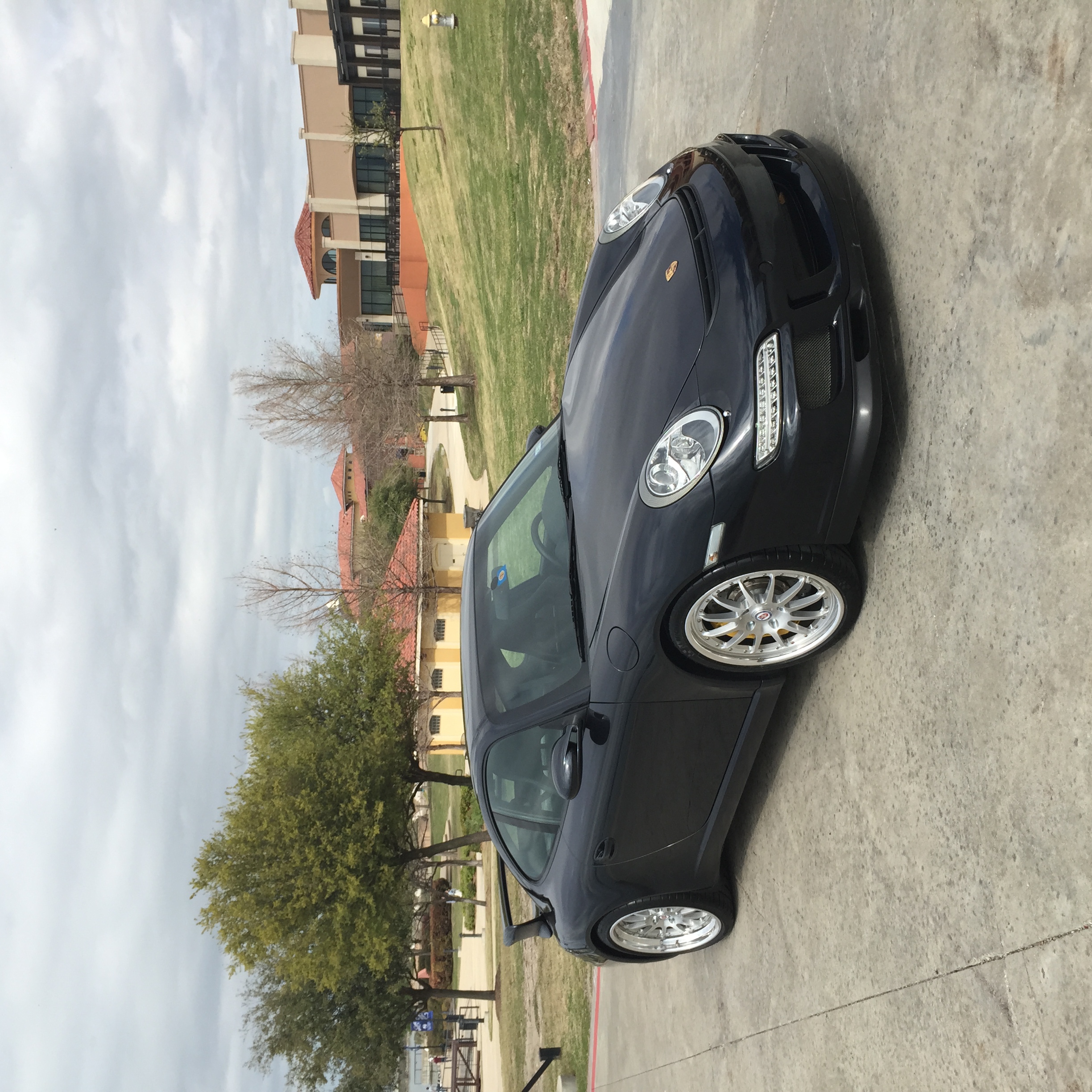

Michelin Pilots are wider than other brand tires, IMO with your setup i would go 295R/235F (Michelin all the way). Have seen other folks ran 305 on 11" wide.
My car have 305/245 MPSS on 11.5"/8.5" HRE, no issue.
