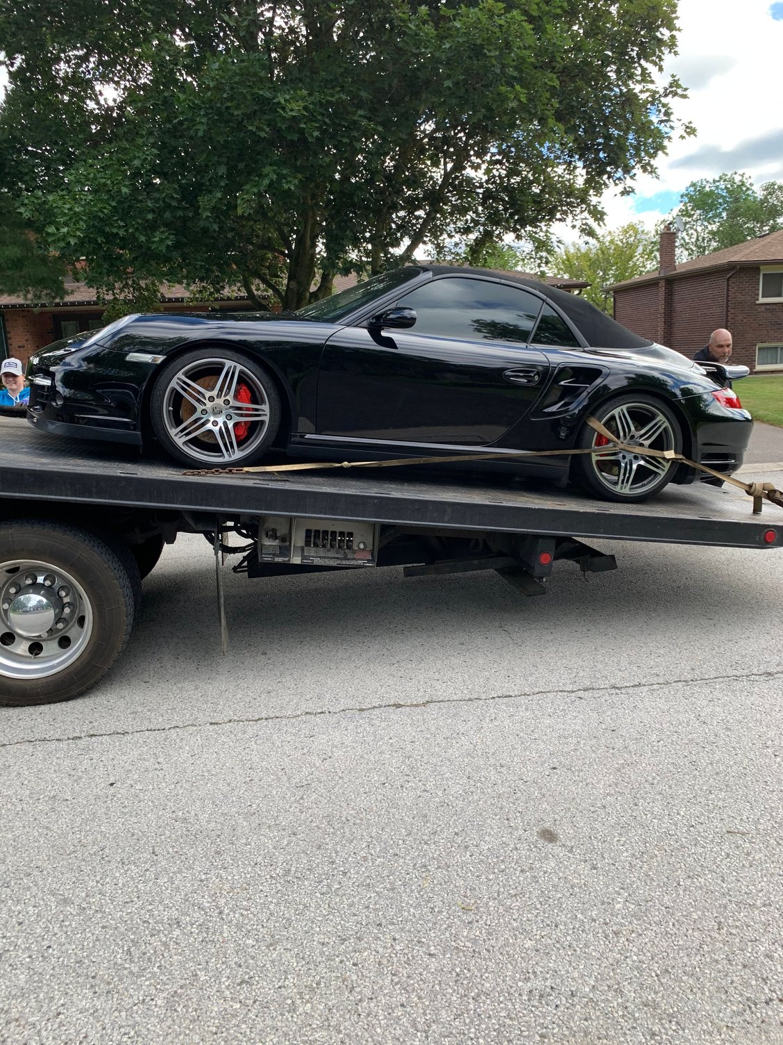

I bought a 2008 Porsche 997.1 turbo cab 6 speed. Had it Porsche pre-inspected and it passed without a single issue. 22,000kms. The car as as close to new as I could find. It’s my dream car and after learning my 14 year old son has terminal brain cancer last December and living with him at Sick Kids for almost 5 months. I decided life is just to short and felt what better way for us to enjoy his last few months together.
I drove the car home from the private seller and the car performed as imagined. A few days later and after learning more about the car I decided to plug in the Cobbs tuner that came with the car along with a car cover. I read the instructions both on paper and online and videos. When I plugged it in and when to ignition state nothing happened. The screen never lit up at all. I checked connections pushed a few buttons wondering if it needed waking up but again nothing. I thought it was broken. I unplugged and took the device to my computer. After plugging it in a few minutes later the screen lit up. I figured the device must have an internal battery that was dead and needed charging. Happy to see it alive I updated the latest software versions and let it charge overnight.
The next day I went to my car to start it up and and it would not start. It did a half turn over but that was it. Just about every error light you can think of was lit. I tried checking over the vehicle, clutch switch, fuses, battery terminals, disconnected the battery swapped batteries. Nothing. Called Cobbs and they went over the device while on the phone, had me plug it in and try installing, uninstall etc. No luck. When trying to back up or install maps it communicates fine with my ECU but stays at 0%, same with installation. The cooling fan runs on and off while the Cobbs is plugged into the ECU for some reason. Anyway I sent the Cobbs and my ECU to Cobbs. 2 weeks later it was returned to me with a request that I tow the car to a Porsche dealer as they felt the problem was fixed and now all that was needed was the dealer to use their PIWIS to force reprogram. 30 minutes tops and the car should be fine.
The car was towed and after waiting 3 days the dealer Pfaff Porsche Vaughan Ontario they said it was a no go and that I needed to buy a new ECU. 4,000 plus plus plus. I decided to sent the ECU to a rebuild and repair shop in Toronto.
5 days later they responded saying there is nothing wrong with the ECU and the hardware seems fine. They did say that I likely have a software problem and said you better talk with Cobbs. I have once again been in touch with Cobbs and I can tell they are shrugging their shoulders and saying perhaps you should just buy a new ECU.
They have suggested trying to have the car towed to another Porsche dealer as the first one was perhaps just trying to sell me a highly marked up and profitable new ECU. I have spent close to $2,000 in towing, diagnostics, troubleshooting and shipping. at this point and the car has now sat for 4 weeks.
I am at a total loss at this point in what to do or how much more money I spend towing the car from place to place. Cobbs seems to feel the problem is no one I have gone to yet knows what they are doing and are not using the Porsche PIWIS system properly to reload the perfectly fine ECU.
Porsche can only recommend replacing the ECU with a new one. The ECU repair shop says it’s likely Cobbs that has their software bricking the ECU and says to hold them accountable for this mess.
Basically all three are pointing at each other. Has anyone every had a situation like this that can make any suggestion of what you would do in this situation?
This car was intended to provide some positive distraction and therapy. Something fun that my son and I can enjoy together during these dark days. If anyone can help or know if a tuner in the GTA that has Porsche PWSIS that can do more then changed parts or can provide any experience with this problem please let me know.

Jim from AMT tuning took on the challenge and managed to clone a identical ECU for 997.1 turbo manual and flashed my ECU. He was able to also determine that the software that Cobbs had loaded was for the correct year and model as mine but was not for sport chrono.
He also noted that likely when the Porsche dealer was trouble shooting the car they removed some fuses for inspection and forgot to return one for the starter. Long story short he was able to help after I had the car towed to him in Vaughan and one day later he had the car running again. I also had him do a stage one tune and the car is running beautifully.
Jim was very affordable for the time and equipment he used to help but also for the tune and software he flashed. I would highly recommend AMT to anyone as Jim was very easy to communicate with and seemed to know exactly what was needed and how to help. Highly professional and his shop was like a work of art.
