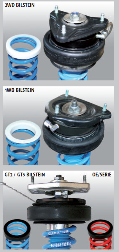

Originally Posted by Punhatch
so without using the Tarett monoballs, will the suspension bolt straight on to the Carrera S? Both front and rear.
May depend on what's included in your airbag kit, but most likely not. The top mounts are different between the RWD, AWD, and GT car variants - see the image below from my cargraphic AirLift brochure that shows the differences in how the suspension mounts to the different cars. Looks like the shock geometry is different on the AWD Turbo probably to account for the additional FWD components. Got coilovers the spring diameters are different too - not sure how that will translate on an air suspension setup. The Tarett monoballs work with all 3 and why I suggested that may be the piece that allows you to do what you're trying to with mixing parts from one model to another.
