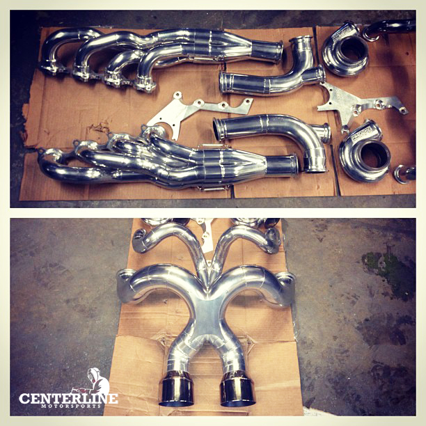

BILLET!!
Finally got the billet brackets in, which look amazing! I’m glad were past this stage now and moving forward now the up pipes, exhaust and dumps can all be welded. I still haven’t decided what I plan to do beyond this point….if I should do a water to air setup or not…it’s a really hard choice, but I know I have to make up my mind soon as things progress.

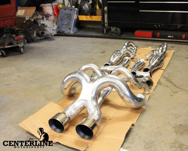

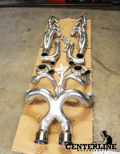

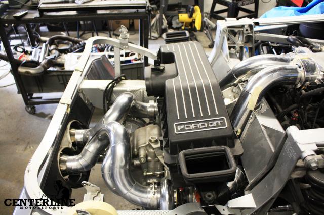

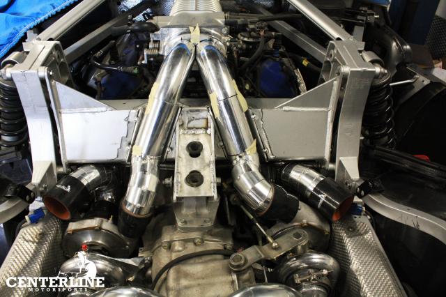

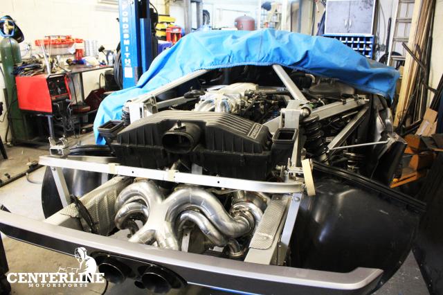

Missing Updates?
Well I got something! The car has sort of been pushed to the side with me as I have been super busy with business and other things in life, but I think it's time I get back into it and start making the push. Centerline has been good to me and have been keeping my car safe on the hoist while I have been doing my thing. I'm glad that this hasn’t been an issue for them as they really do good work and I wouldn't want to take my car anywhere else.
Pipes are a bit off as the tape came apart and since it was about to come off to be tacked together, but I’m sure you guys get the point here! Clearance is a huge issue and thats why the pie cuts had to be used!
