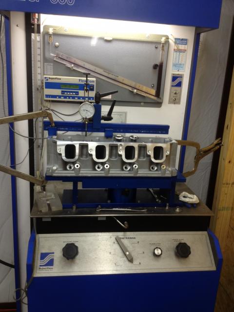

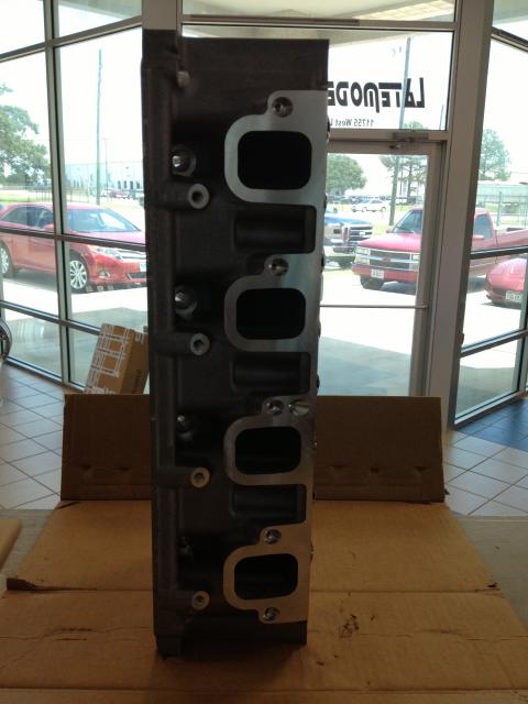

We have received our LT1 castings from GM and have already flowed/torn down and started grinding on them. Overall we should have numbers very soon.
Our before numbers were as follows:
Was flowed on a 4.060 bore at 28" of water with a Untouched port and valve job.
lift Intake Exhaust
.200 134 120
.300 204 164
.400 258 193
.500 291 204
.600 285 208
.650 291 210
As you can see our bench seems to read lower than others. 1 other well known shop out there besides us posted 318 as there stock numbers. So dont take final Flow numbers to make decision on whos is best. Flow benches are just like dynos. Used for tuning tools, and to see gains.

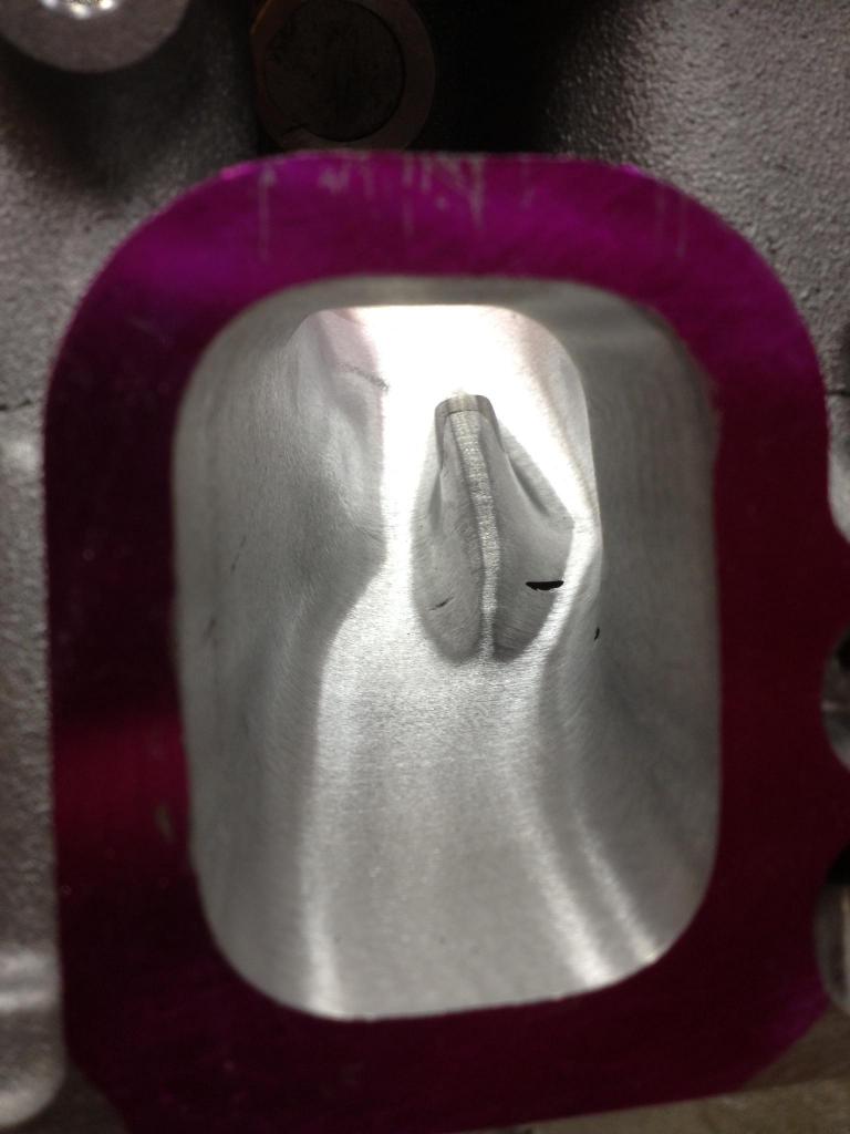

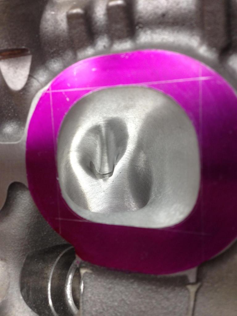

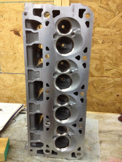

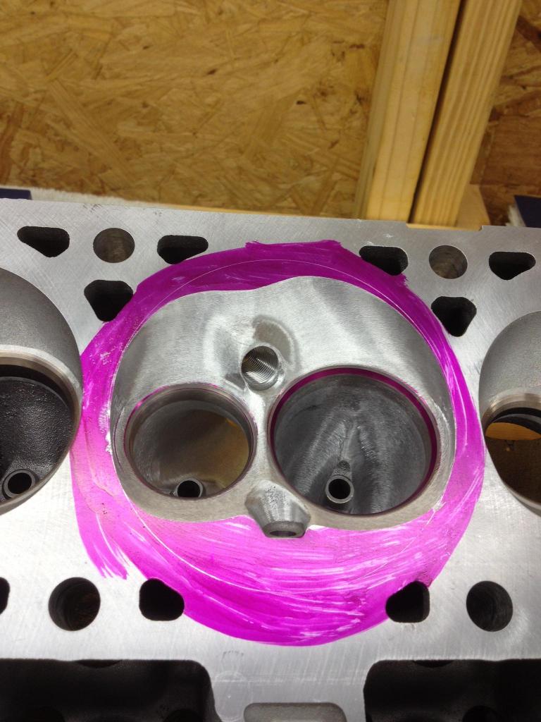

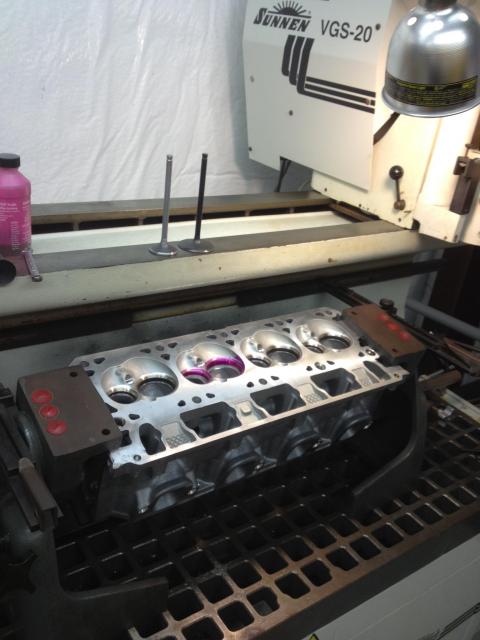

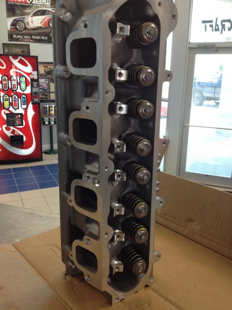

And now for some pictures
And now the fun part begins!
Roughed in Exhaust port
