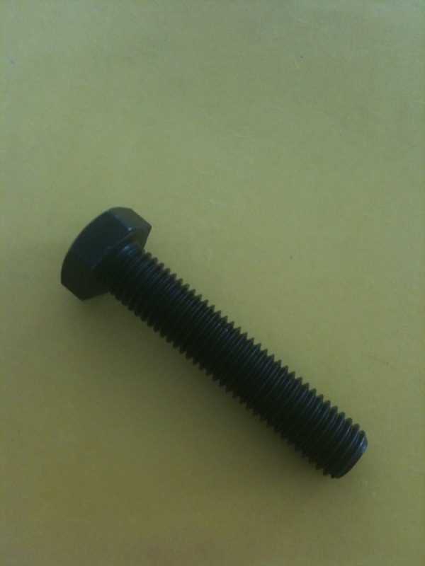

Having a centering ring really makes wheel changing easier. Has anyone installed a set yet? I received the box of lug bolts last week from RSC and they are not the press-in type like the stock ones. They are just plain bolts, threaded all the way to the head. They also don't appear to be tapered at the ends like the stock ones.
I'd like to know for sure these will work before I take everything apart.

Posted some stuff in the braking thread but will update this as well. We finally have everything sorted for wheel spacers and will be offering them in 10, 15 & 20mm standard sizes. It turned out to be an absolute mission to source appropriate studs (although we now how 9.8 steel, which is two grades above what is normally used in automotive applications). Thanks again to those who helped us in development, I know it was a hassle. If it is any consolation, the final cost in producing these ended up being more than some of you guys paid for your complete set! Our price on these is going to be $695.00 and they will be made to each customer's order so will probably take about 3 weeks.

I've had to send them to the machine shop. We have only been able to source them in 78mm lengths, which means they have to be machined down. I thought we still had enough machined studs left but I was mistaken.
