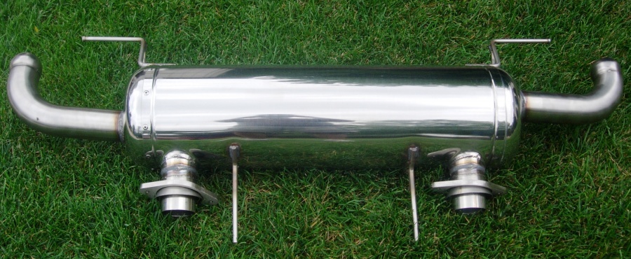

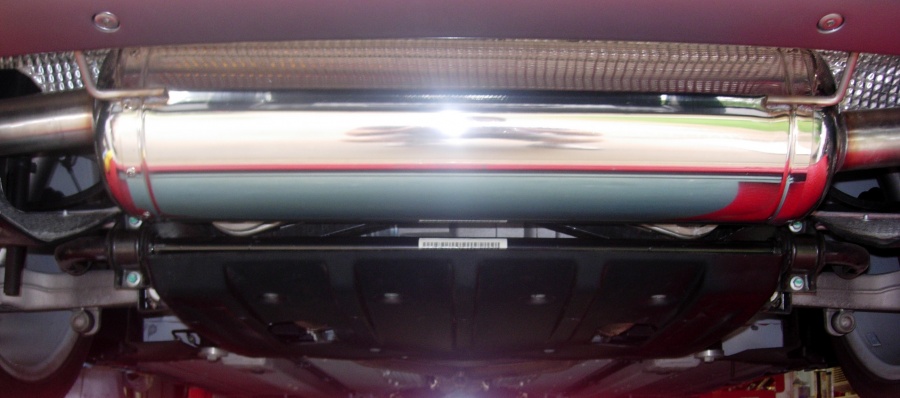

After much anticipation I finally received my RSC Tuning Super Sport Exhaust late last week. The unit I purchased is the “louder” version of RSC’s updated design that is much more aesthetically pleasing than their original design. The pictures on their website accurately reflect the design and quality of this piece. I have also attached some pics for your reference. The welds are very professional and the unit is made of steel polished to a bright finish. It weighs much, much less than the original OE exhaust. I did not weigh the 2 for comparison but the weight savings are huge! ☺
I did the install myself with a friend on Saturday. Both of us are pretty mechanically inclined so we were expecting a 2 to 3 hour job max. It ending up taking us about 5 hours for a few reasons. First, we went deliberately slow in an effort not to miss or damage anything upon removal of the original system. Second, there were no directions or instructions included with the exhaust so we were kind of in the dark. Third, I had to go to NAPA (auto parts store) to get two doughnut gaskets to mate the new exhaust to the post cat section of the OE exhaust. The dealer was out of stock on the gaskets (crazy that the dealer would not stock a part one would think would be quite common. You almost need this anytime you disable an exhaust for anything????) and we could not get the original gasket off the original exhaust as some had suggested. The trip to NAPA took 1 ½ hours. I used a generic doughnut gasket and it worked fine. We got a good seal and there are no leaks. Note to others-purchase a pair of gaskets BEFORE you disassemble everything. It will make the job much easier than having to explain to the NAPA parts guy that you are replacing an exhaust gasket on an Aston Martin. He looked at me like I was from another planet.
Also, let me advise that a lift is almost necessary if you plan to do this yourself. I can’t imagine doing this job on my back without adequate clearance or coverage. It would be a nightmare.
The removal of the original exhaust took much longer than installing the new one as the new one is much smaller and you can easily maneuver it around under the car. i.e. there is additional clearance with the new one and it is not too heavy. I would recommend anyone doing this job to have a buddy on-hand as you will need someone to help hold things in-place while you bolt/un-bolt parts, etc. Also, make sure you have some socket extensions as some of the bolts and screws can be awkward to reach. The most difficult part is the removal and alignment of the tips. Now that I have done this I am confident I can do the job in two hours or so. I’m glad I did it as 1.) I enjoy doing this stuff and tinkering with my car and 2.) I saved ~$500 from a dealer install. ☺
As for the sound, it is awesome! I am very pleased. This is how the car should have sounded from the factory. It is deeper in growl in comparison to a fuse 22 pull. There is no drone or resonance whatsoever. It is very smooth. The car now has a more aggressive sound much lower in the RPM range than the original where it was most needed. It is not too loud at all. In fact, I was kind of hoping it would be a little louder than it actually is. When you are not heavy on the gas and just cruising it is very quiet and totally manageable. This is a system you could easily live with everyday and not ****-off your neighbors if desired. However, push the pedal to the carpet and it rips and tears like it should! I am very happy with the purchase and Stuart from RSC was honest, helpful and a pleasure to work with. As for performance, who know but my butt dyno picks up a small gain. It could be mental as it sounds awesome or it really could be a combination of better flow and weight savings. Whatever it is I am pleased.
I would highly recommend this product if you are in the market for an aftermarket system. BTW, I have no affiliation with Stuart or RSC. I’m just a happy customer.
BTW, I will post some video later on once I get a buddy to help with the video camera. Also, if there is anyone in Chicago that is contemplating one of these and would like to hear my car I would be happy to meet up and share the love.
Adam

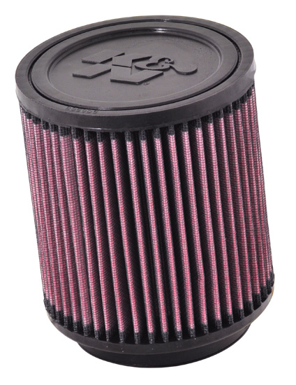

Hey, is this K and N filter the universal one that looks like this ??
Does it just bolt straight on to the existing filter points in the box ??
Cheers!!
