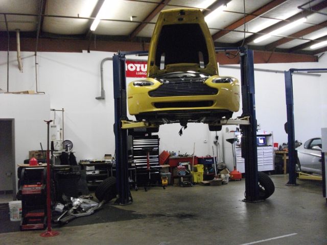

Mr. Zambono brought his V8V in to us for a clutch change. The obvious decision was to upgrade to the RSC Tuning kit. So far, I'm very pleased with everything as I had expected. The build quality of the kit is great, installation was straight forward with no funny business and of course initial performance is solid.
The pedal is noticeably lighter and although the clutch disc has a good deal more bite, engagement is still smooth and acceptable for everyday use. I'm looking forward to seeing some mileage get put on the car for long term wear and performance data. So far we're off to a good start though.
