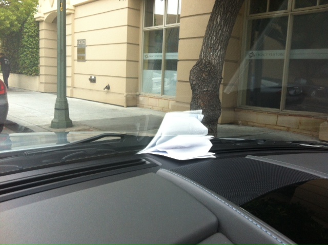

The constant (and very annoying) squeaking that I am now hearing all the time seems to be related to a bum install job on the windshield. My dealer keeps insisting that the installation was done correctly, but after I showed them my fix to the squeaking (see pic below), I think they might have to concede that the windshield was not set properly. Seems to make total sense as this squeaking only start AFTER the windshield was replaced.
I spoke to a windshield installer who explained that the windshield actualy floats on a layer of urethane glue. Sometimes, if you add too much or too little, it affects the height at which the glass floats on the car frame and in my case, it looks like its sitting too close to the plastic vent area (i.e., too little urethan was applied).
The trick now is trying to figure out how to wedge something in between the glass and the front vent without (i) replacing the entire windshield or (ii) removing the whole dash.
I'm leaning towards having them replace the windshield as I fear removing the dash will need to a host of other problems....such a mess (something I expected to aviod by going through my local AM dealer).
