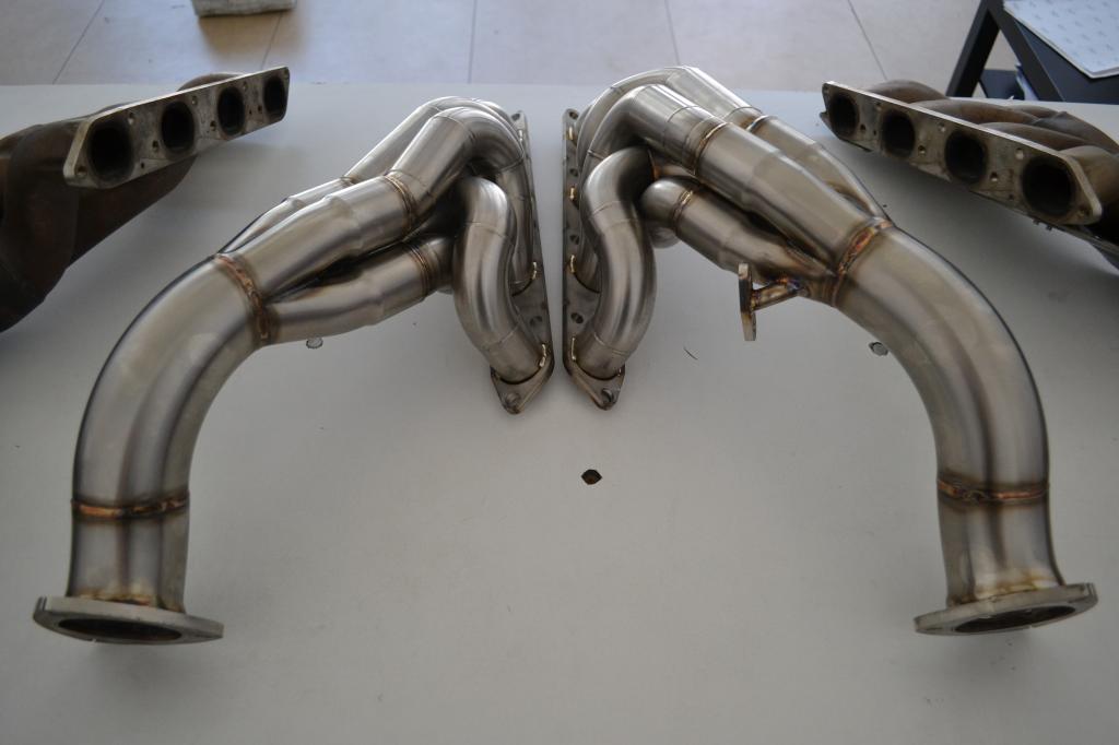

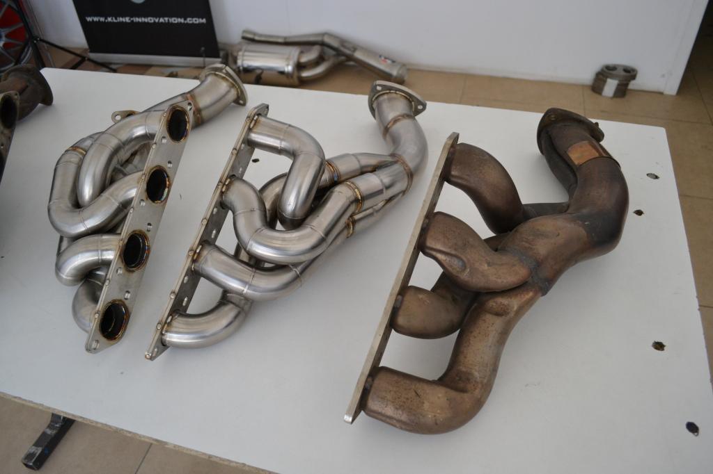

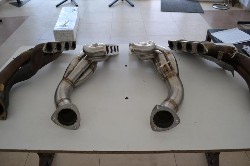

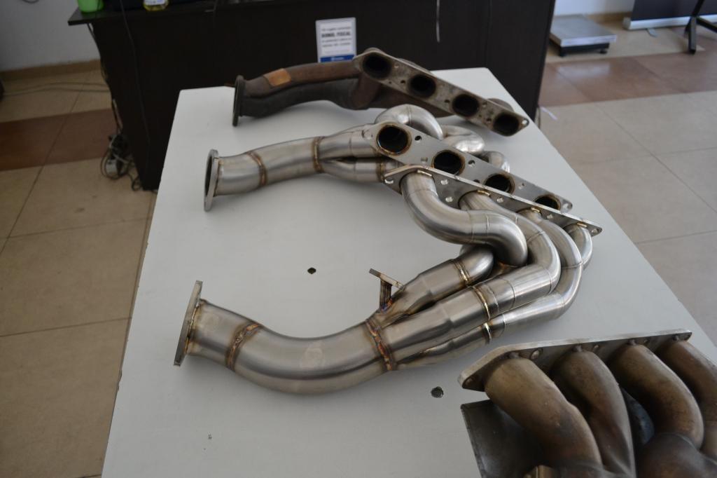

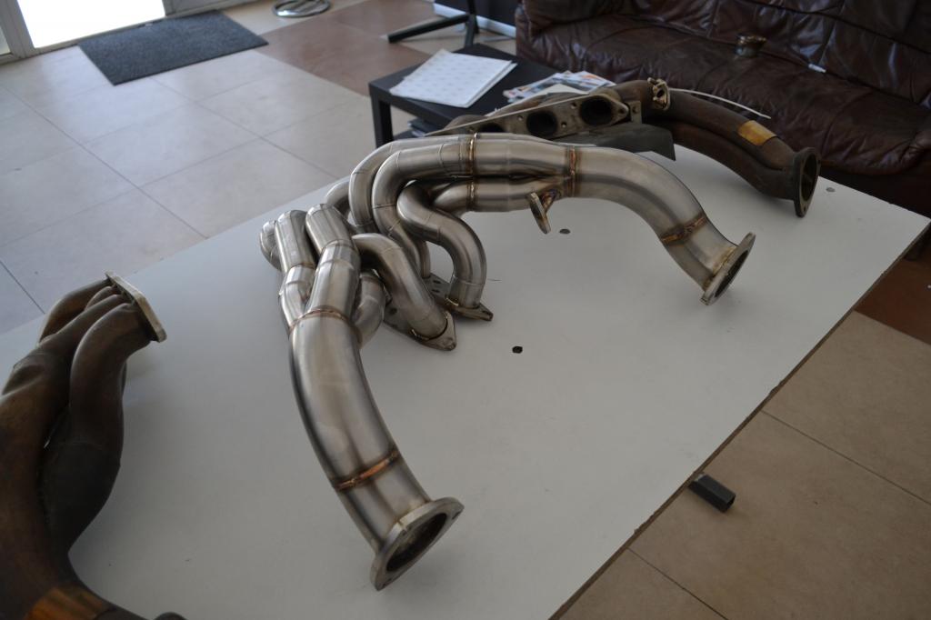

Correct me if I am wrong but your design looks more like a shorty header while the stock ones look more long tube (even though they have a lot of restrictions). Sorry just what it looks like based on the images.
Just a question on the collector, have you guys tested if a prefabbed smooth port one is better that the one you offer? Again based off images it looks like the welds are in there disturbing smooth air flow.
Just wondering based of images.

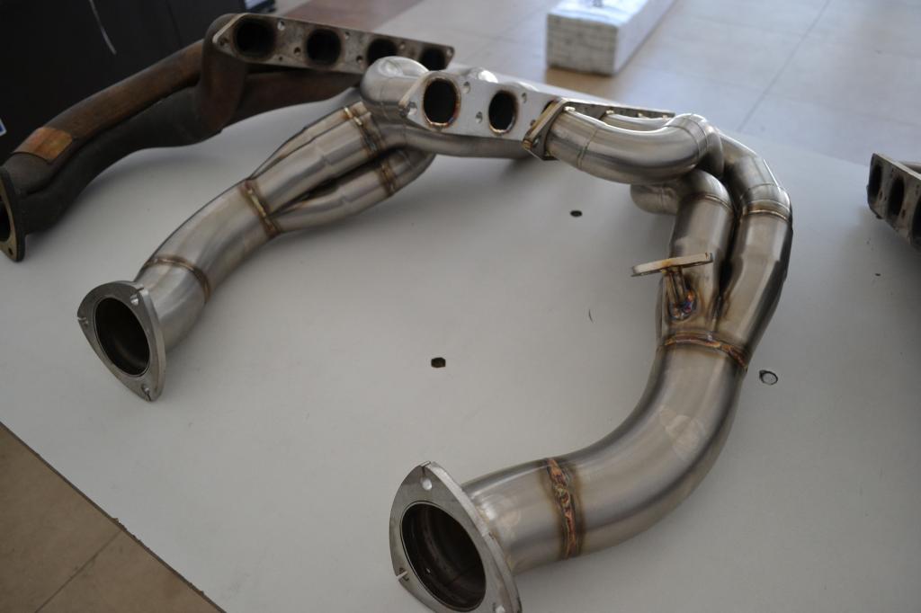

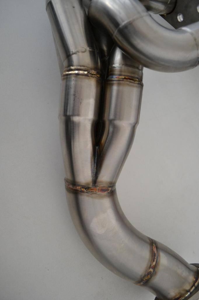

The equal lenght primaries in our design are longer than the longest primary in the OEM setup, and MUCH longer than the shortest one. The OEM is sort of a 4-2-1 although considering that the '2' part is really only 1/2 a pipe each I'm not sure that it really is.
By 'pre-fabbed smooth port' I'm assuming you mean a formed collector rather than the fabricated merge collector we use? A formed collector will produce less power than a built merge collector does. This has been tested and confirmed (although not by Velocity.) Formed collectors are cheaper because they are 'prefab' but the airflow does not merge as effectively.
The welds inside the collector barely disturb the airflow at all, certainly whatever tiny disruptions they cause are nowhere near the same level of effect that a prefab formed collector has on the airflow so although more costly and time consuming, the merge collectors we use are a superior part for this application.
