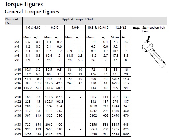

from the V8V manual, but probably the same:

Telum01 thanks a lot for the torque chart! I'm sure it will come in handy for a lot of other projects that I have panned!
