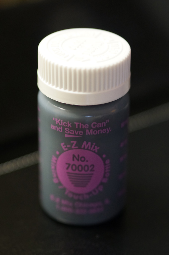

To my surprise the local Aston Martin dealership does not actually carry touch up bottles (Many manufacturers do, such as Mercedes etc, but Aston unfortunately does not). Luckily, the Aston dealer referred me to their official paint shop: Katy Coach Works.
When I arrived at the shop, to my surprise I found out it was a certified Paint Shop for both Aston Martin's and Mercedes benz (how ironic/appropriate given their newest partnership). All I had to do was give them my color & VIN # and they provided me with a 55ml bottle (roughly 2 ounces) of Meteorite Silver paint with build in brush in the cap all for only $60! Wanting to do it the right way I went to the local Art & Crafts store to get all the necessary supplies to do this the right way.

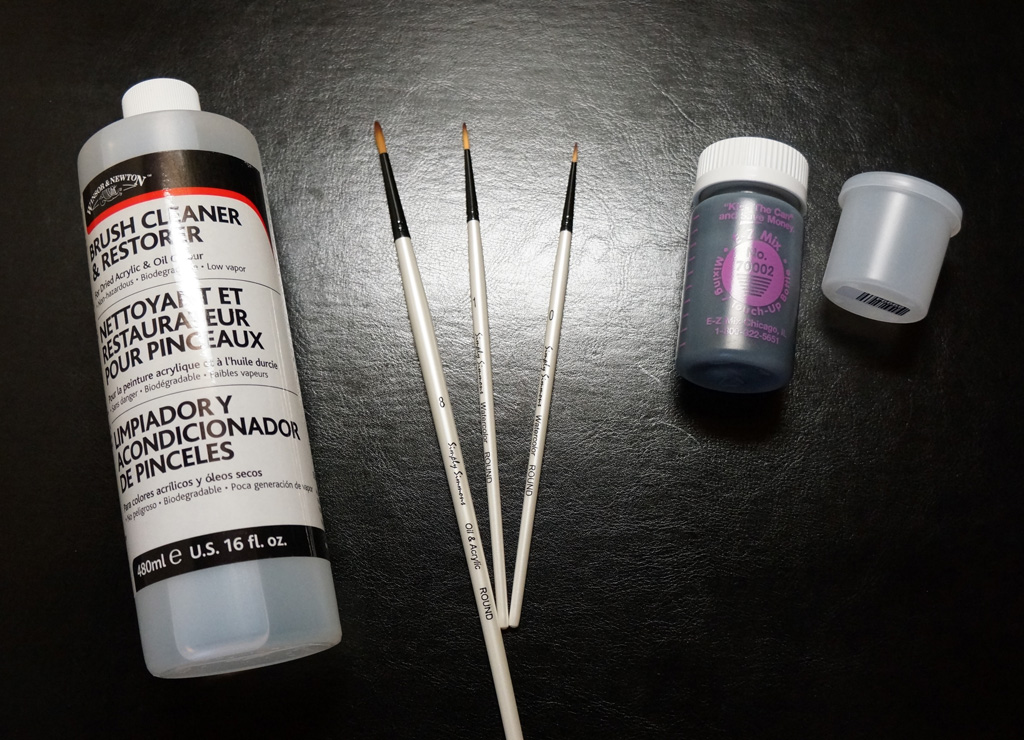

Supplies:
- Paint Bottle (supplied by katycoachworks.com) = $60
- Fine tip synthetic paint brush = $3.50
- Brush Cleaner & Restorer = $15
- Small Plastic container (for brush cleaner solution) = $1
- "Invisible Glass Cleaner" (Or windex) = $6
- LED flash light = $5-10 at most stores (Costco sells them in triplets for dirt cheap)
- Isoppropyl Alcohol + Q-tips (optional) = $1

Supplied by Katy Coach Works was a fantastic match, not 100%, but about 95% match. Anything beyond 3-4 inches away and you cannot even see it (so much so it was hard for me to remember where I had put paint as I was filling in the chips/pits)

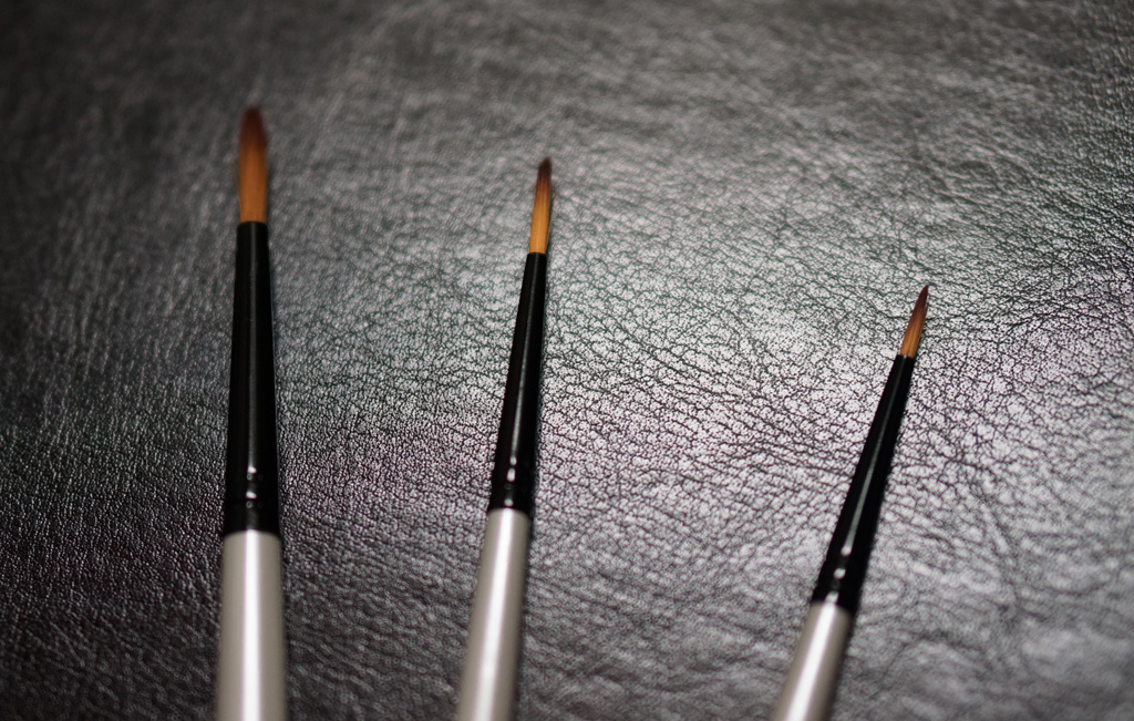

Although the paint bottle comes with a build in brush tip in the cap, its WAY too big, you cannot use it to fill in the pits as it is simply too large and will just put globs of paint on the surface. For that reason I bought 3 different size brushed from the art store. In retrospect, the two larger sizes were completely unnecessary (I included them in the pictures for reference so you could get an idea of just how fine a tip brush you need). I only used the finest point of the three: size zero. The art store clerk recommended I use synthetic bristle brushes as they are stronger, more durable, last longer, can be used with wider variety of paints, and best of all they are the cheapest.

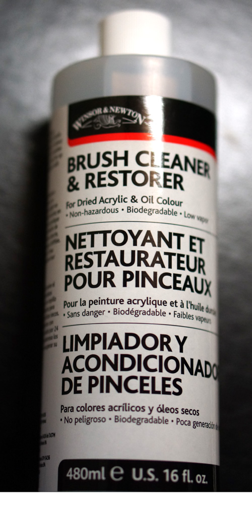

Brush Cleaner :
At first I thought this would not be necessary but the art store clerk insisted I get it because it make cleaning up brushes. I am glad he did because not even isopropyl alcohol would break down or remove the touchup paint once it dried. The automotive grade touchup paint is MUCH stronger than I had anticipated so I am glad I got this for cleanup purposes. Once the Automotive paint dries, it is extremely durable/hard/tough. NOTE: DO NOT USE THIS CLEANER ON THE CARS PAINT!!! ONLY FOR BRUSH CLEANUP (it's essentially similar to acetone, but non toxic and biodegradable).

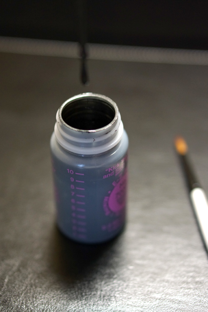

Once you have prepped the surface, shake the bottle of paint vigorously for 10 seconds (and do so periodically ever few minutes throughout the entire process). Unscrew the cap and lift up the built in brush applicator. Since the fine tip art brush is so fine you don't need to tip it in the bottle itself, just brush it inside the larger cap brush applicator until there is enough paint on it to transfer to the car. Keep in mind, the paint dries very quickly in the air (about ~20 seconds) so you have to constantly reapply more paint and keep the tips of the brushes wet. Put the cap back onto the bottle every time you replenish the brush tip with paint. (side note: Keep the paint bottle indoors away from extreme temps)
