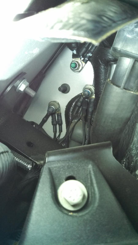

I have seen this before but on older cars. We had a lot of the grounds at the firewall in the engine bay with insulation behind them cause a lot of issues. This would be one of them. If you want look in the engine bay on the passenger side of car near the fusebox, On the firewall behind the fuse box look at the grounds. You will need a light. See if any black insulation is behind any of the nuts.

Tremendous advise... chasing ground issues is a pain in the butt. I didn't really see a problem with the insulation but I double checked the bolts. They were all well fitted and I gave them a quick twist for good measure. The error hasn't reoccurred in several days. Thanks for sharing your experience.
