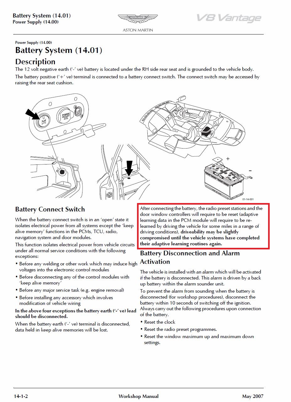

My OBD software automatically selects the protocol, etc. It doesn't offer a way to select a different vehicle.
I don't trust my closest dealer AT ALL. I have several service orders from my car's previous owner where the dealer's diagnosis shows they are either 100% incompetent or 100% lying - for $169/hour! They also gave me misinformation when I was looking to get my clutch replaced.
Here's a page about reconnecting the battery from the workshop manual. I put a red box around the part that says the vehicle will eventually re-learn its adaptations. But there is stuff in the manual that is wrong, too. So who knows!
