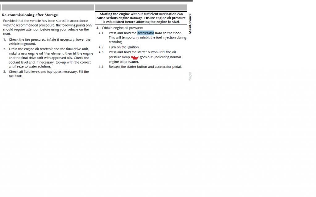

Originally Posted by oo7
Myself as well, that is how I found extended storage start procedure.
An Aston "trick Thread" should be started detailing the obscure things in the manual and others that aren't as a reference for us all. Someone more knowledgable than myself should lead.
"Extended storage start procedure" ? Please explain.

I think he's referring to the pressing accelerator all the way to the floor before turning on the key, this allows the engine to circulate the oil before actually starting the car. Additionally, the battery disconnect switch use as well.
