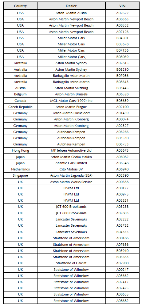

here is the list of cars needing a re flash when fitting clear lights:

Easier to flash, but another trick would be to open both units and swap out the boards inside. I was able to do this on mine. Just be sure to re-seal them well. I would install them first to see if you have an issue.

I installed on my 05 Db9 and did not require a reflash.. Worked perfectly with no issues at all. Go ahead and just get any pair you can find.. You'll love the results! Really updates the look of the older db9's.
