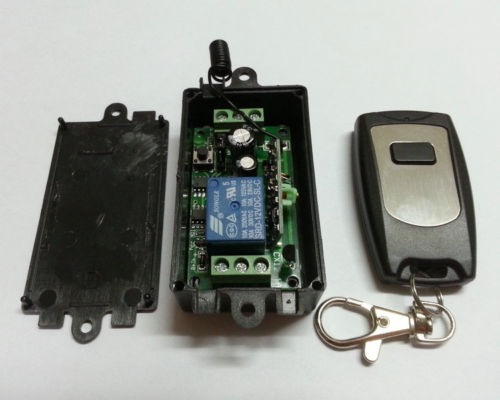

I have always wanted to install a remote switch for the exhaust valve but I also wanted it to be as original looking as possible. I managed to find a switch with a relay circuit built-in and decent looking transmitter.

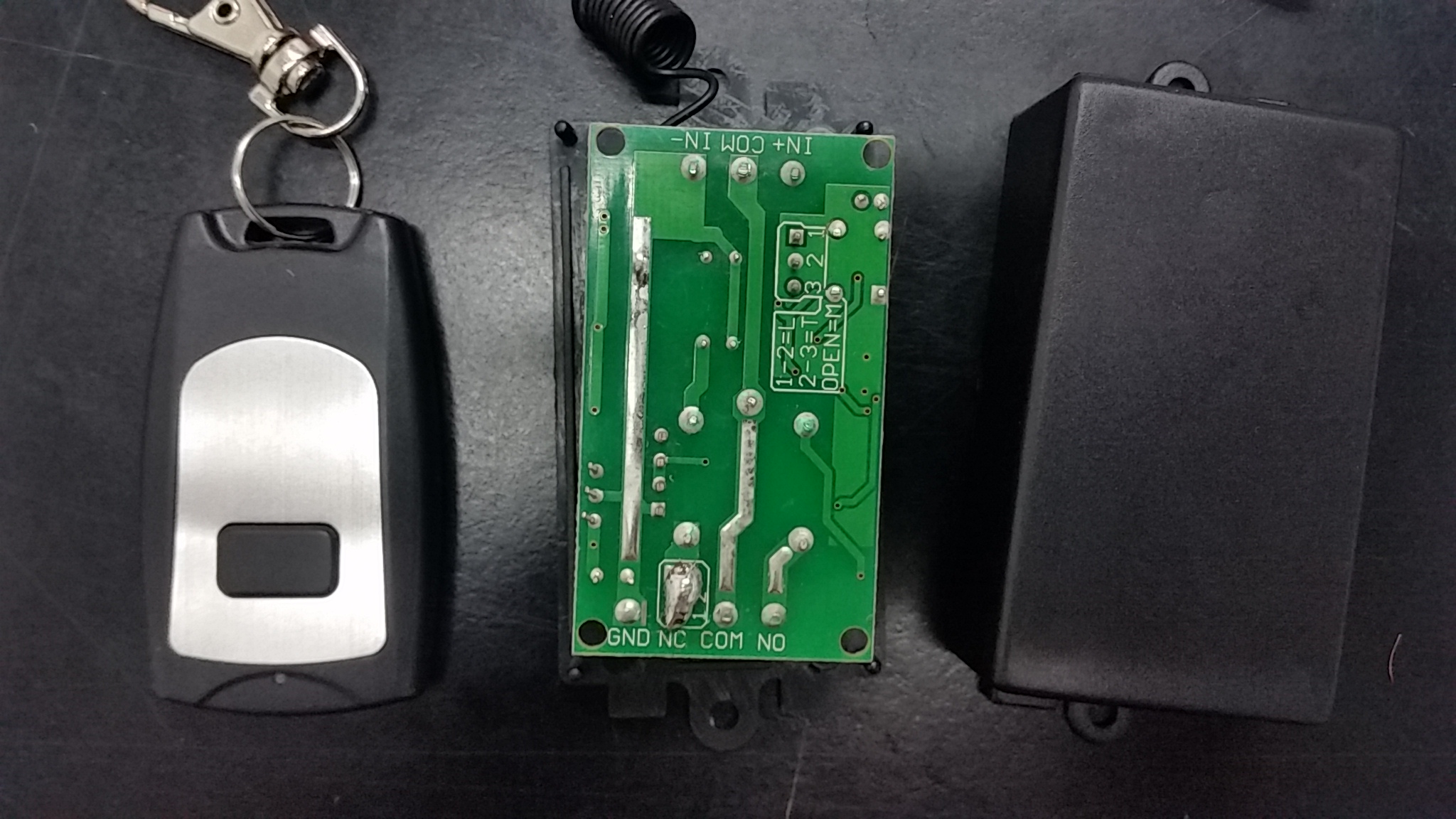

I wanted the exhaust valves to remain in stock mode will I triggered the switch so I modified the circuit to start closed.
All I needed to do was to solder a connector on the circuit board.

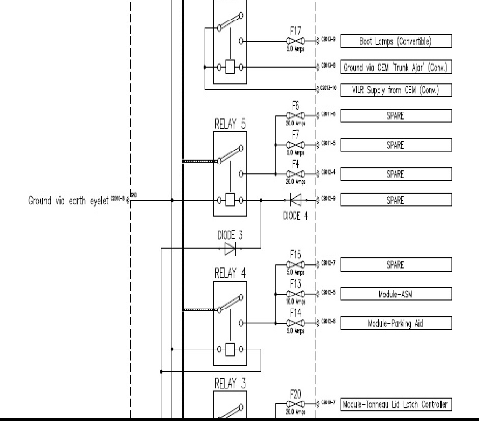

With the help of the Aston Wiring diagram. I made the following connections
12V to the receiver = Fuse F7 (marked as spare)
GND to receiver = GND tapped from Relay 5
Fuse 22 = NC and COM on the receiver
The receiver unit uses 5.5ma on standby and 32ma when triggered of current. So I figured a 5amp supply to it would suffice.

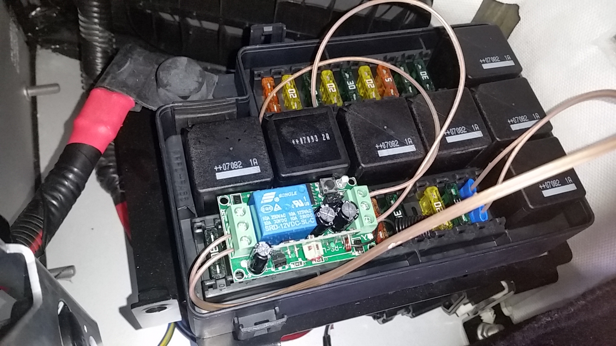

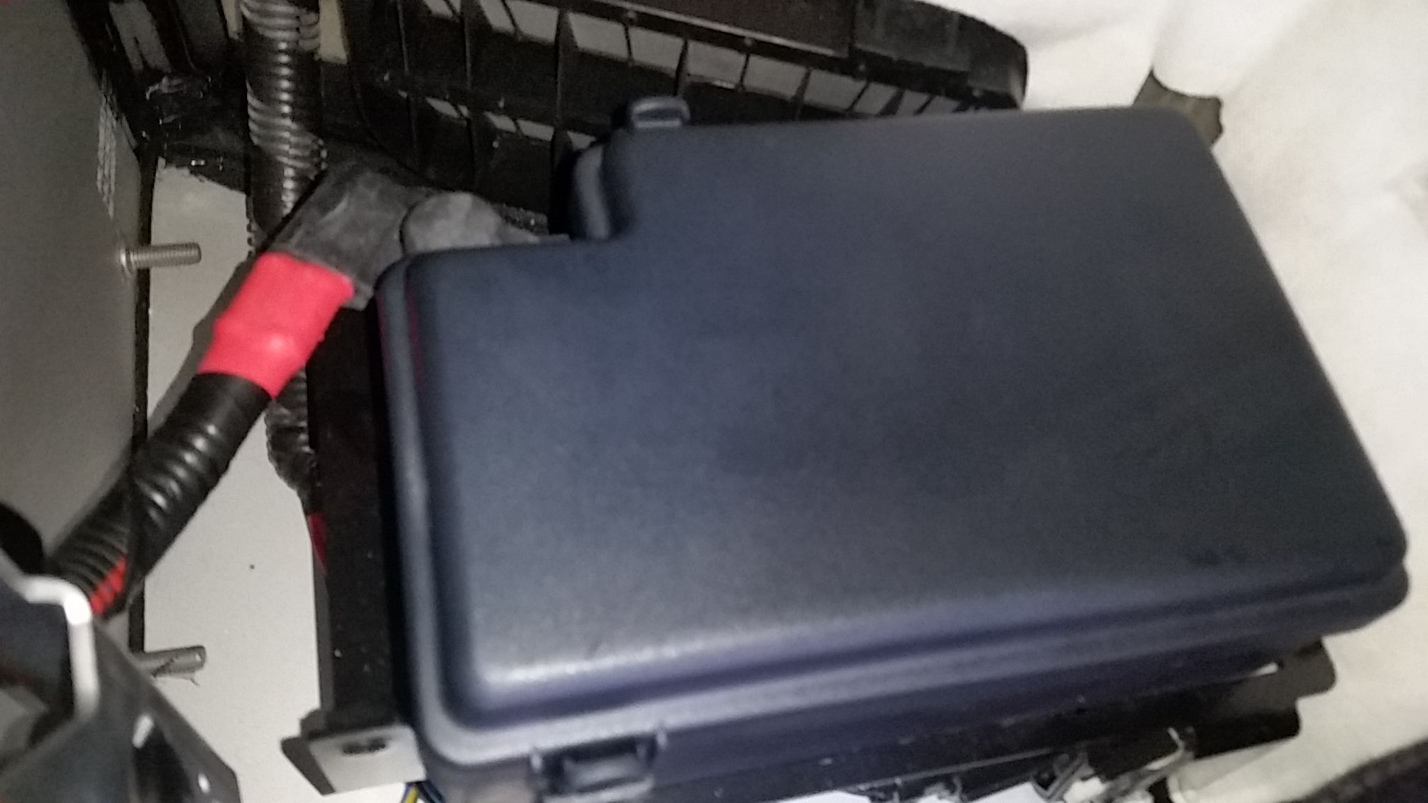

Here is how it looks installed and with the fuse box closed.
I am going to test it a little, tidy the wires and fuse the connection.
Messy now but It works!!

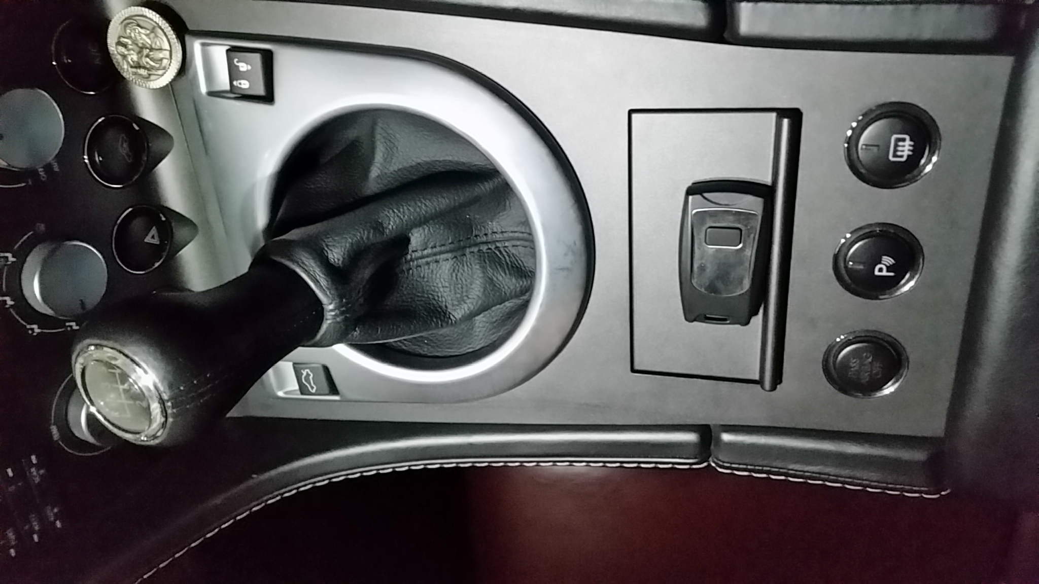

The car starts with the valves is stock mode and when I want to wake the neighbors, I hit the switch which I blu-tac on to the center console.
