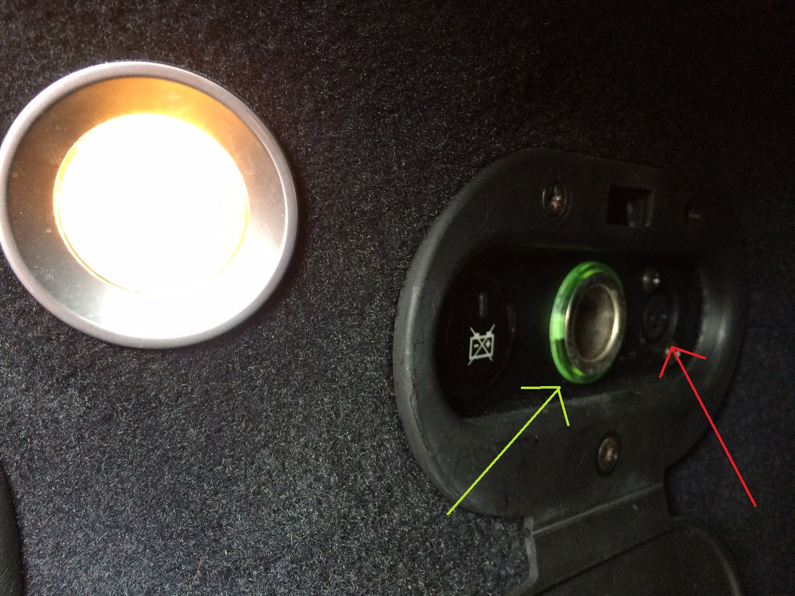

As I need a charger for my '04 DB9 and have found this OEM one http://astonmartinbits.com/models/4-DB9/parts/2226 which is for early cars that have a 3-pin connecter in the boot.
My car sports this 3-pin connector (see RED arrow) so I'm pretty sure its a straight fit.
However, reading about the CTEK 3300 here on the forum its a lot cheaper to get one of these any modify it correctly to fit the cigarette socket (see GREEN arrow).
Can I use the CTEK 3300 without causing issues or shall I go with the OEM 3-pin one?

Or you can just replace the connector on the CTEK with a 3 pin XLR connector from radio shack (which is what I'd do, since the XLR provide a more secure connection).

Even better indeed if it's that simple! Thanks for the tip.

Chaps,
One last thing: Since I'm in the other part of the world and on a UK-style / 240V network I'd asked CTEK the 240V / European equivalent of the CTEK 3300 (which is obviously the US-spec unit). They came back as follows:
Hello,
This charger is not big enough for the vehicle application. The UK equivalent of the the Aston Martin charger is the MXS 7.0: http://www.ctekchargers.co.uk/ctek-mxs-70.php
Kind Regards
Dominic
The 3300's maintenance voltage charges from 12Ah to 75Ah (charging) or 12-120Ah (maintenance).
This MXS 7.0 seems to be a bit bigger in capacity [as stated by Dominic]: 14-150Ah and charging at 7amps.
Could this be any issue or can I go ahead with the buy?
