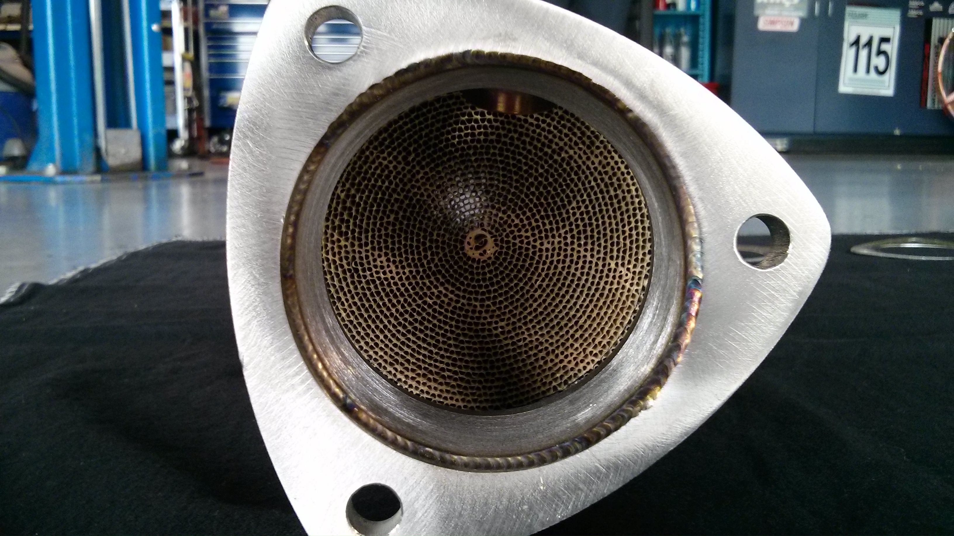

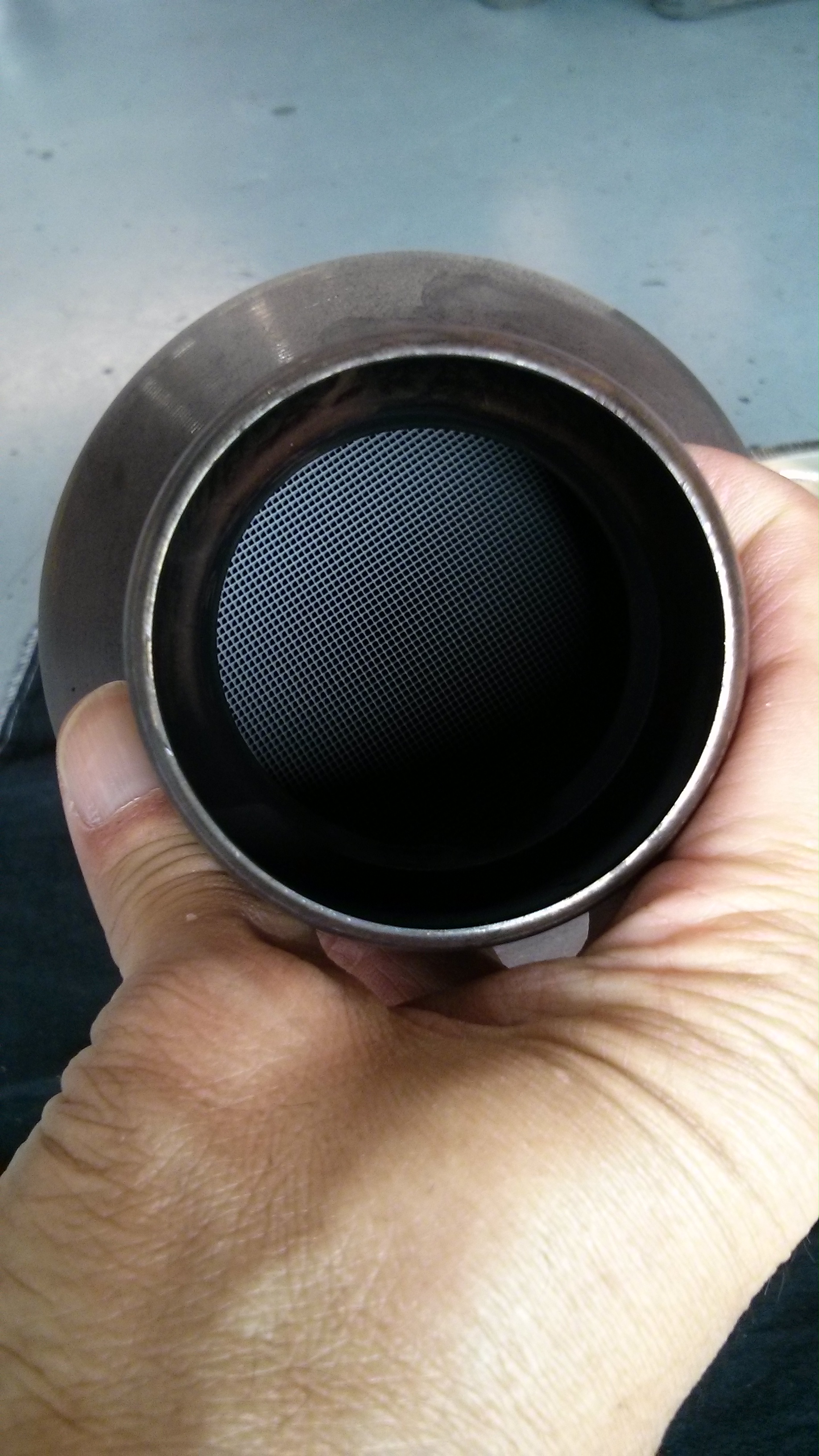

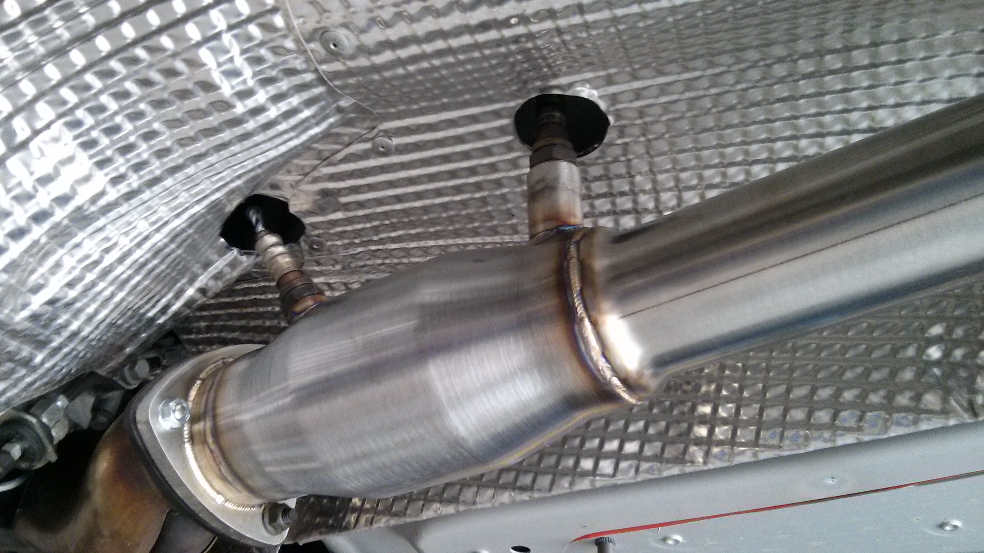

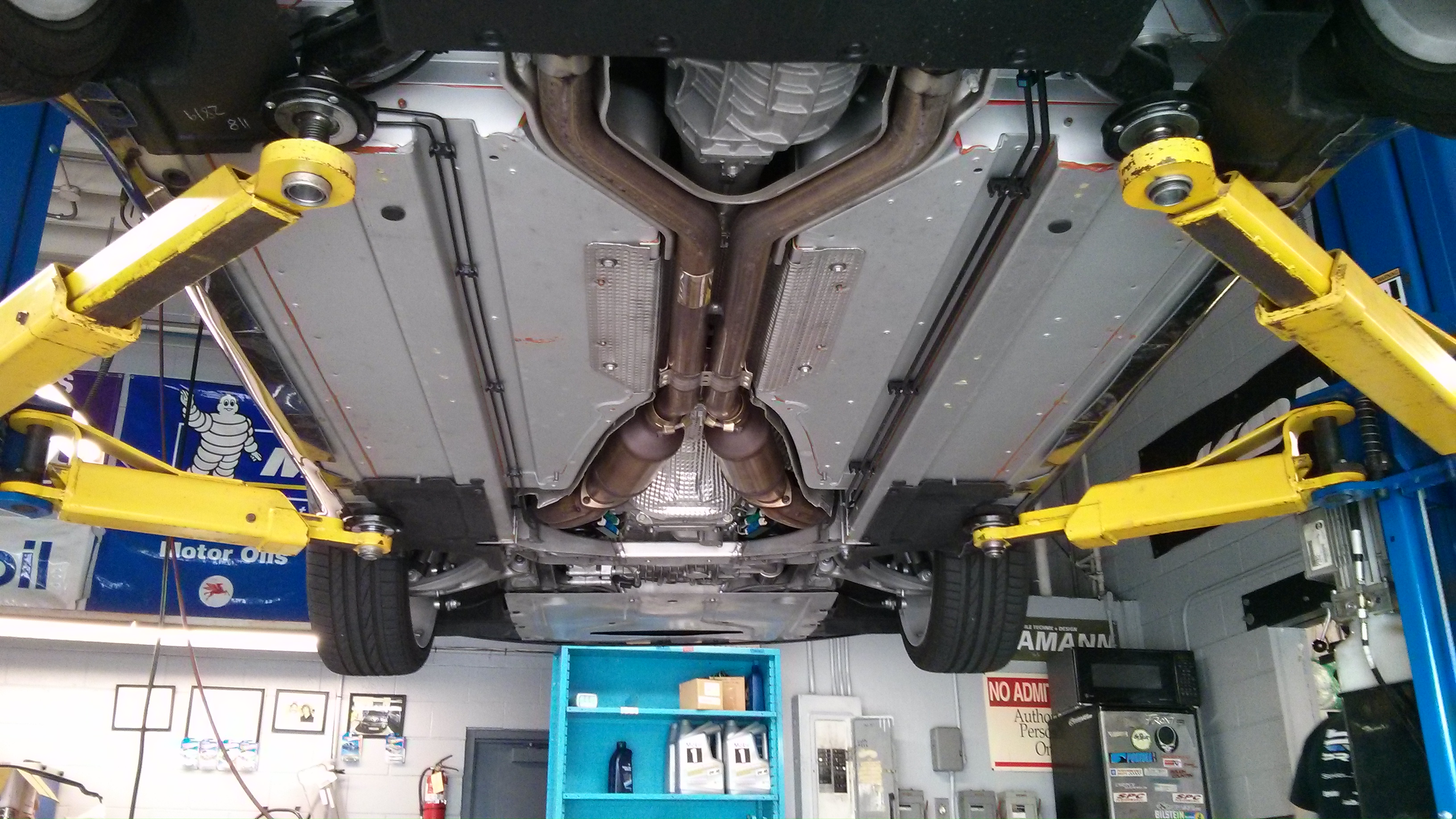

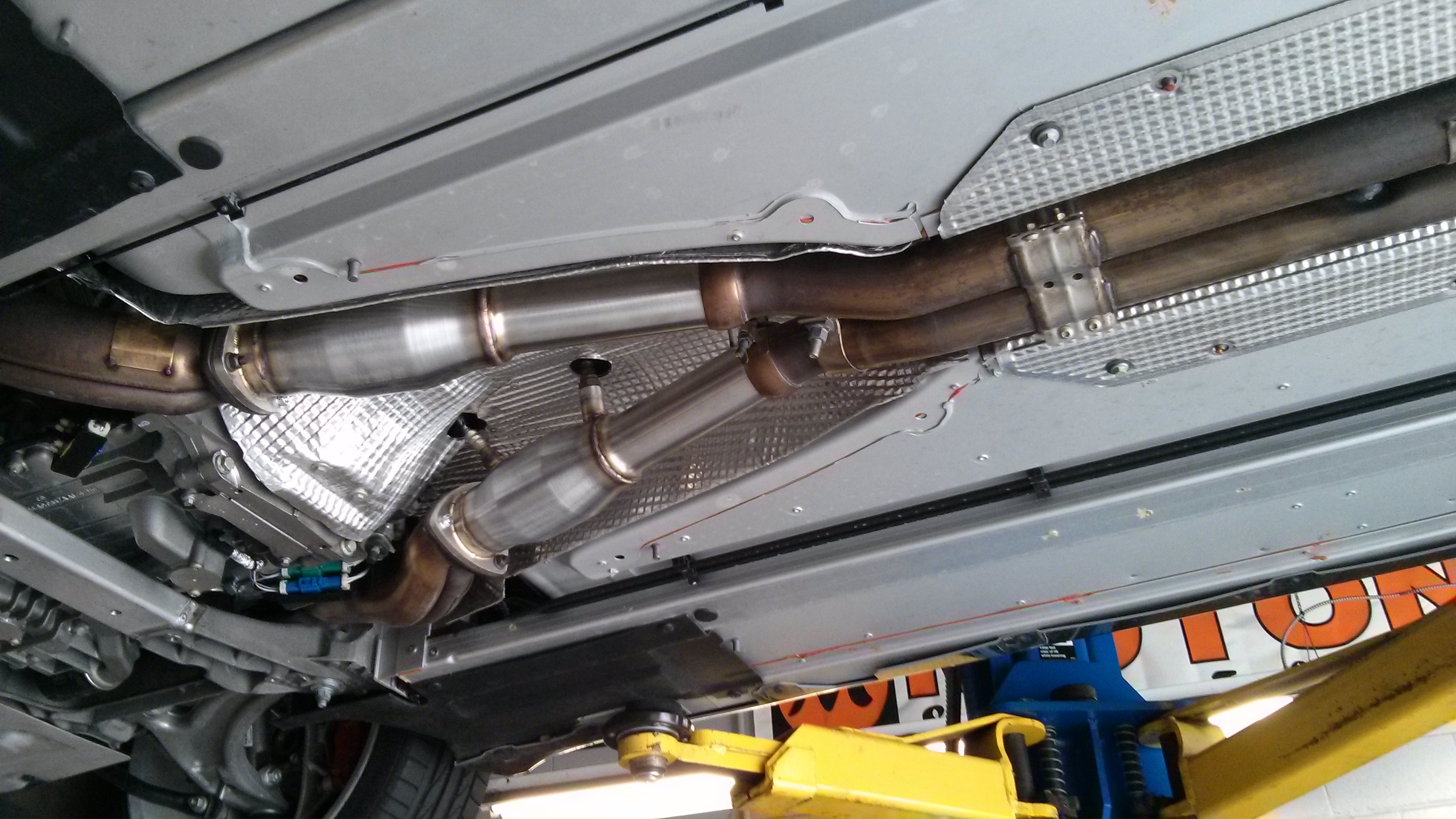

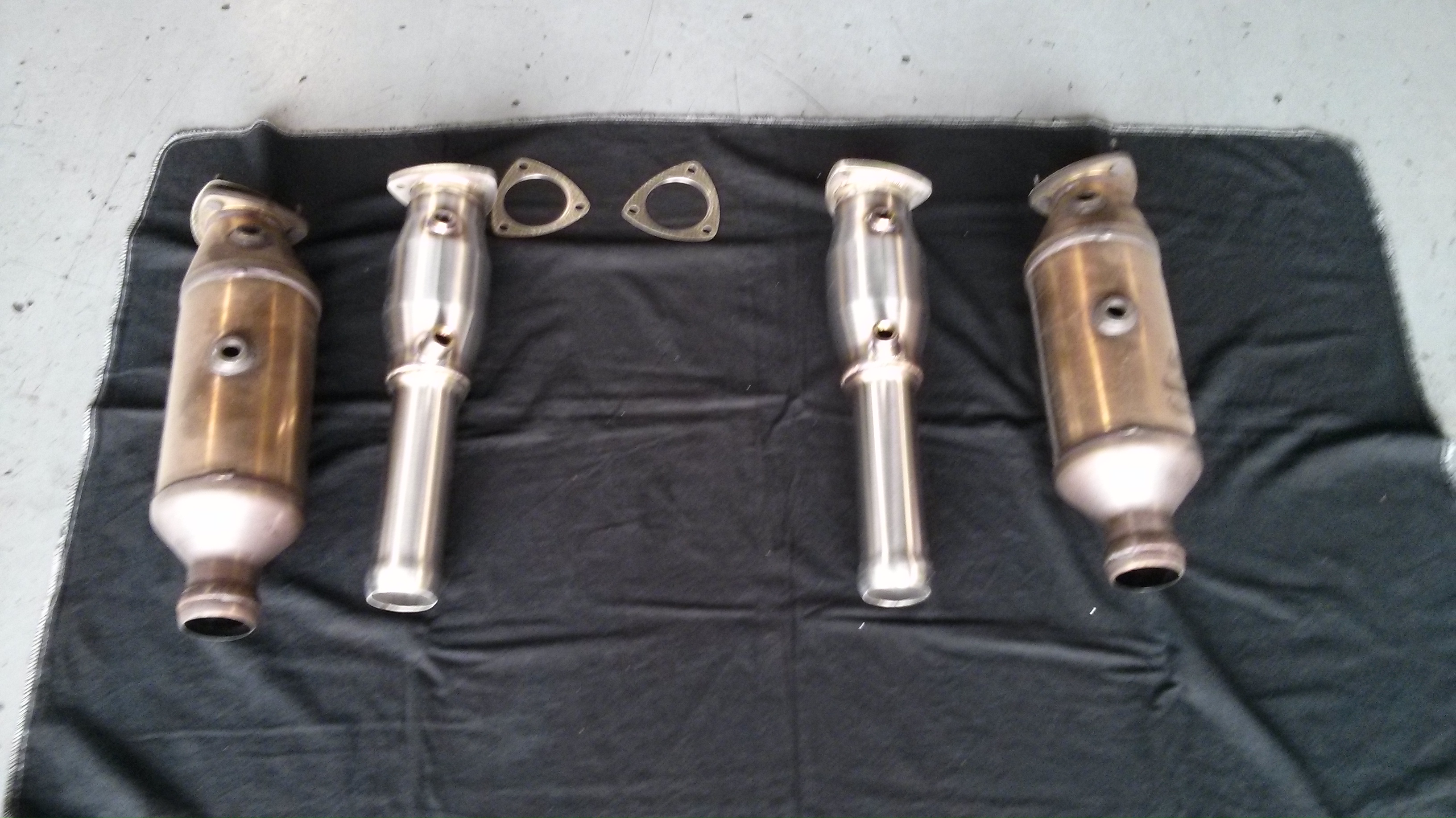

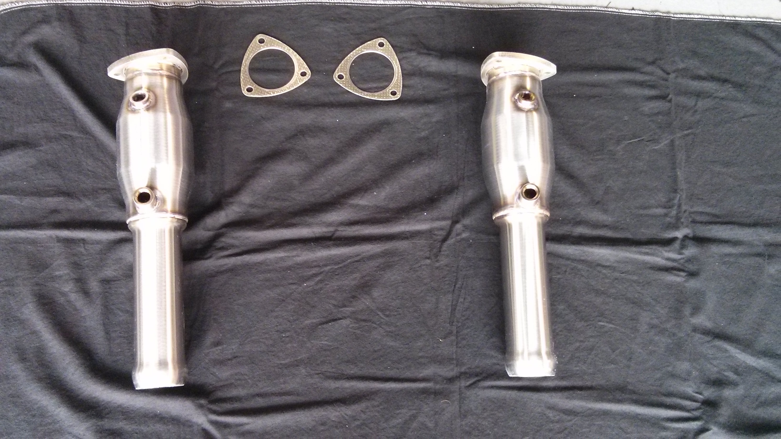

Thumbs up Got the HS CATs installed
Well, I got HS cats installed yesterday at my tuner shop and it took about 45 minutes total. They just loosened the 3 bolts at the header, removed the rear clamp and pushed the pipes back about an inch or so to make room to drop the cats. They came out without too much hassle.
There is a right and left side to the cats as the O2 sensor is in different locations. The HS cats matched right up with the original cat's locations and the O2 sensor holes in the heat shield aligned perfectly for a true bolt on solution.
007 Vantage is right on with the sound. I had been running my car with fuse 22 pulled for a long time so I'm used to the louder exhaust note. Just for grins, I put the fuse back in the weekend before the HS install and drove the car for a few days. I forgot how quiet the car is with fuse 22 in when it's not on full wide throttle.
With the HS cats and fuse 22 in, the sound is slightly higher in pitch than with fuse 22 out and it's a slightly more raspy sound. It's very nice and I love it. As others mentioned, with the fuse 22 back in, you'll get the awesome sound on take off and then it'll get quiet again until you open up the muffler baffles... and then it's WOW! With both the cats and wide open throttle, the car's like a Le Mans racer coming through.
My tuner and I took the car out for a test trial and opened it up several times and it sure turned a lot of heads. Very pleased and no check engine light what so ever after a day of driving. I'll have to play around with fuse 22 in and out and see if it's too loud for everyday driving with it out.
As for the power, you'll notice it. I didn't do a dyno test as several others have done it and the results looked fairly consistent in their output. The low end is definitely better and the car takes off the line quicker. If I had to sum it up in one thought, it's like the car lost several hundred pounds. I've driven multiple Porsches for 15+ years before owning this AM V8V and the Porsches are lighter and the take off is more "immediate". Coming from the Porsches, I noticed the Vantage's weight difference right away when I purchased the car - but the HS high flow cats have nullified that "weighty" feeling somewhat. This is what I think the Vantage should have been like from the factory.
For the money, this is definitely worth doing in my opinion. I've also done the ECU tuning from the ECU Tuning Group and together, the low and high end is definitely improved over stock. Between the two, I haven's spent that much (less than $2.7K US installed) and the gains I've gotten over stock is well worth it in my experience.
007 Vantage, thanks for the great post and details. I'm a believer!
Sam at Enjuku Racing. Thanks for the service and advice.
Here's a few pictures of the "before and after" with the car on the rack.
1st pic: Car on the rack with the factory cats
2nd pic: HS cats and new gaskets
3rd pic: 200 cell cats
4th pic: Factory 600 cell cats
5th pic: Factory vs HS high flow cats

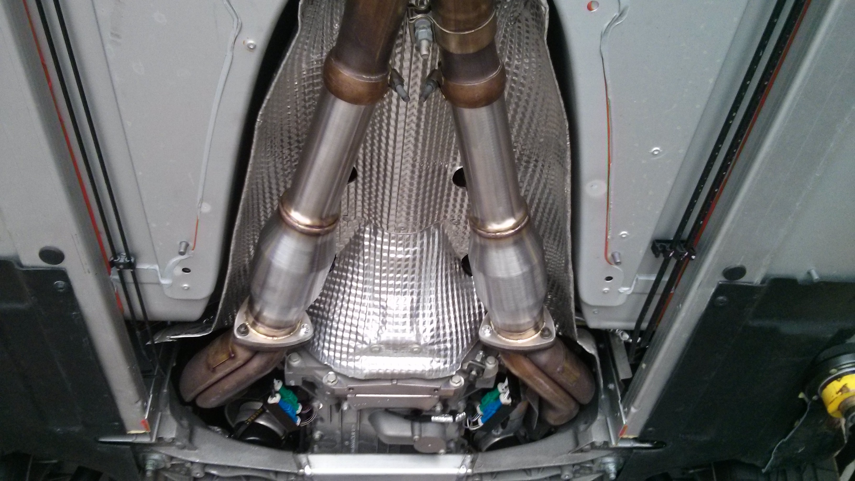

Remaining Pictures for Install
Here's how the HS cats look installed. The HS cats are also quite a bit lighter than the factory cats too. Small bonus on the weight savings...
Cheers and hope this was helpful. https://www.6speedonline.com/forums/...lies/smile.gif
