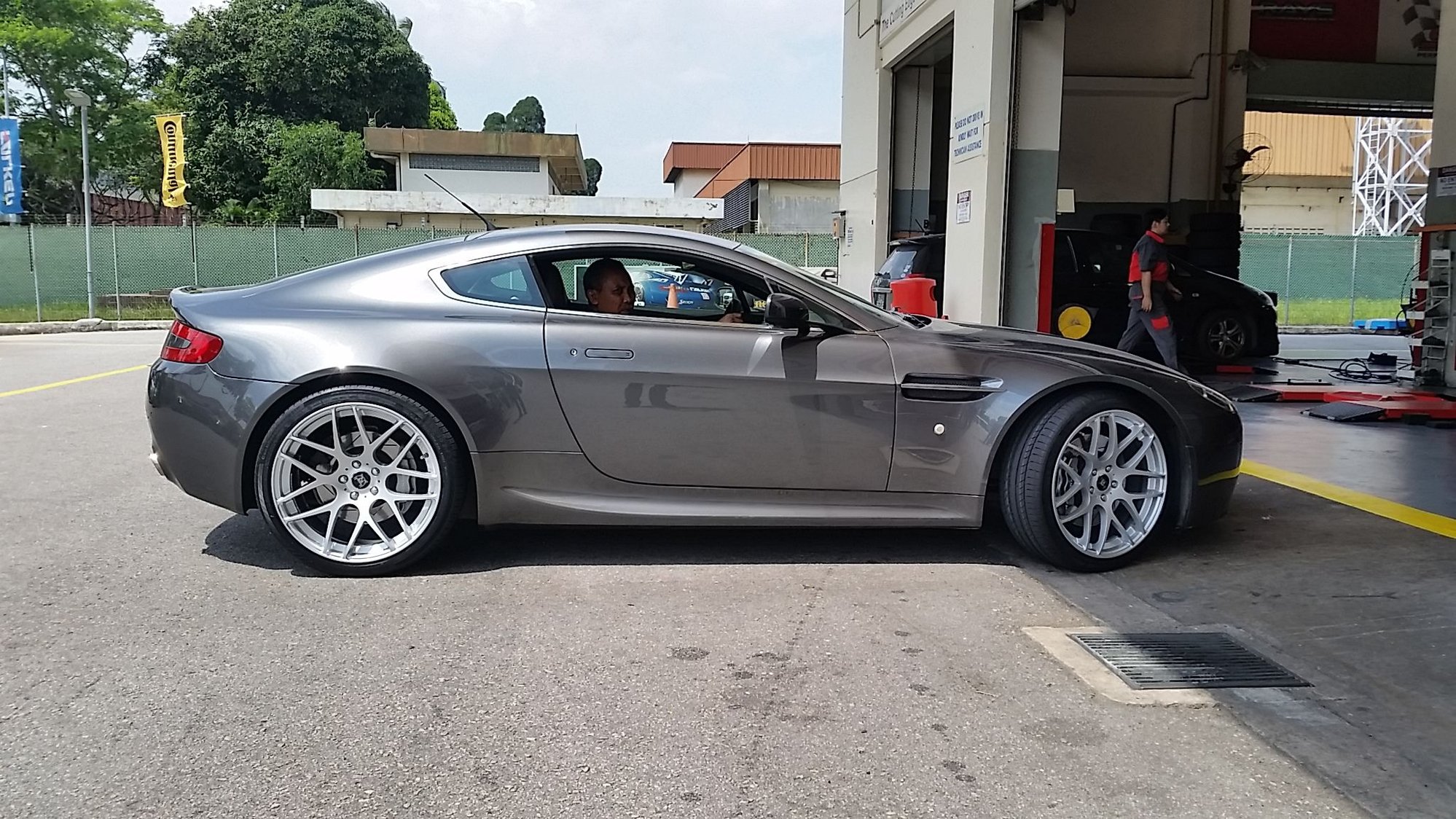

About to be aligned with the 20inch rims (offset to fill the arches)
Originally Posted by 007 Vantage
If you are willing to upgrade wheels I would recommend just upgrading wheels with the correct offset to fill the wheel gap. If you just want spacers you can do that it just requires a bit of labor as you have to put in all new wheel stud bolts to accomodate for the thick spacers
VelocityAP new springs are probably going to be your best bet, they should be released here shortly in the next few weeks (if you can wait a little bit).
I got wheels with the correct offset and it looks way better.

Well done Jeremy! You did it the right way. Wheels look amazing!!

I think that fitment looks fantastic. I don't like when cars look slammed and yours fills the gaps without the drop.

yep that is spot on!
I need to know all the details on those!

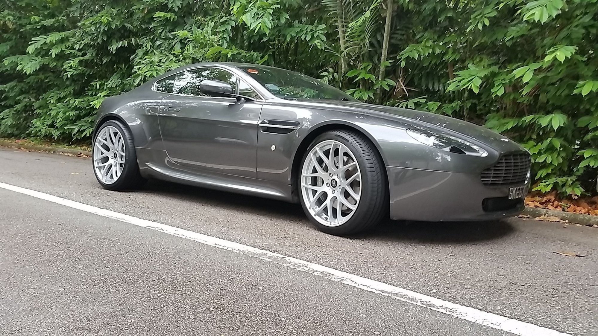

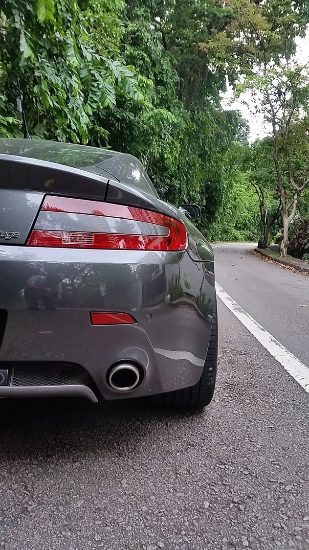

Rear running with a 5mm spacer to see how it looks. From the top its flush but from the front the tyre is visible
Front is perfect. Rears +5mm spacer to be flush with top of body or without spacer to be flush with sides of body.

A small drop would still look very good, perhaps just lowering the rear would balance out the ride height better. The rear is sitting higher than the front
