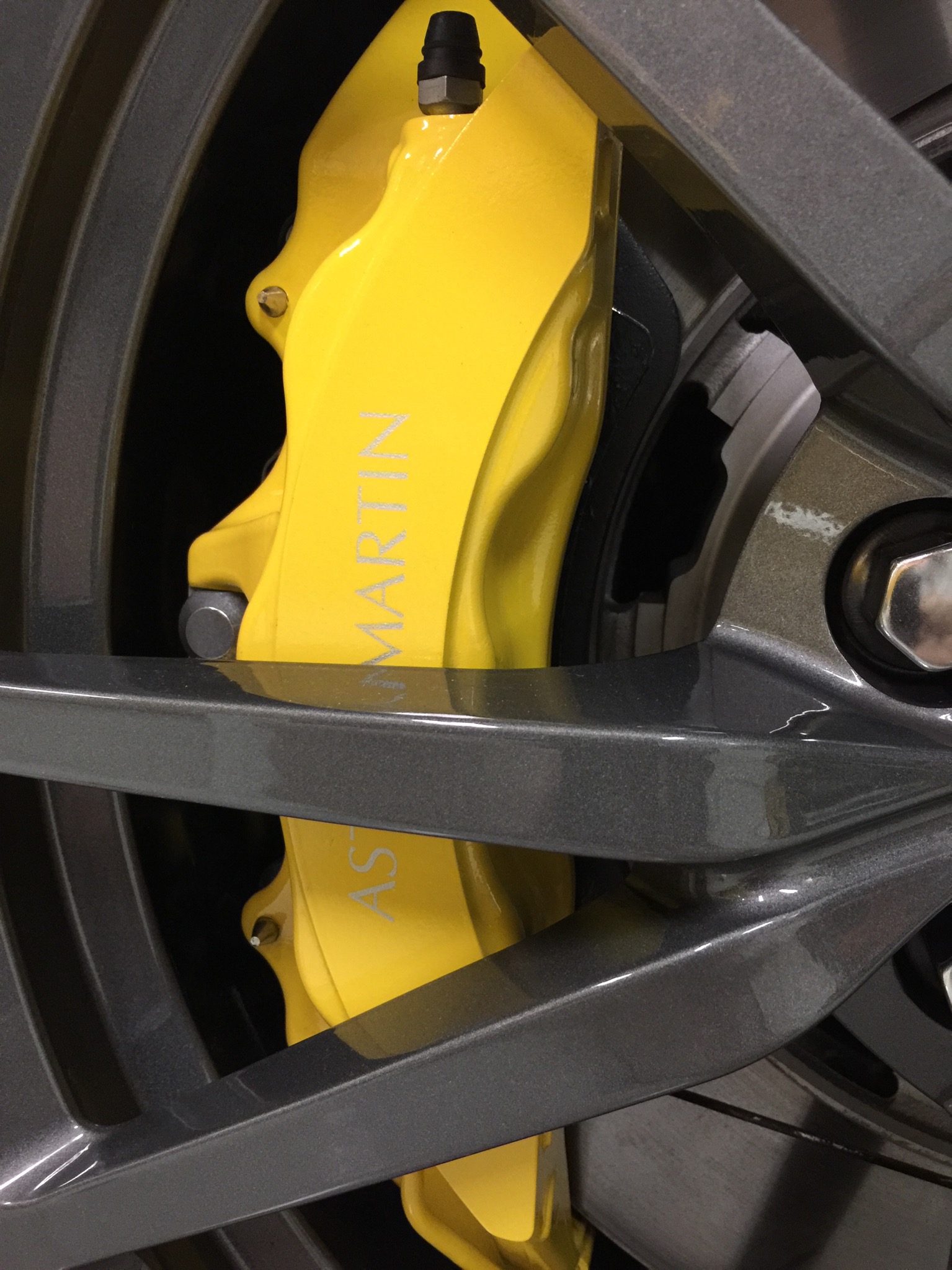

Maybe it's different on the two-piece rotors. But on the newer dual-cast rotors it's still pretty far.

It shouldn't matter if they are close should it? They won't move any closer once placed.

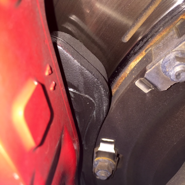

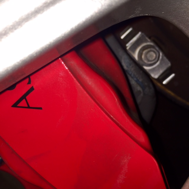

My new R4-S pads were just installed, and they, too, look like they're right against the hat. If so, I'd assume the backing plate will just wear away and be fine. I certainly hope it's OK, here are two pics so you can see.

Cattman,
I had the same issue and Stuart sent my pictures to Porterfield. They took the pads back and took some material off to improve the fitment. Porterfield and Stuart were very helpful and made it a quick turnaround. Hope this helps.

Thanks. Stuart offered the same to me, but I've been driving a bit and everything seems absolutely fine, so I am going to leave it alone and enjoy the silent and dust free experience of these Porterfields. Sooooo nice to drive the car and be able to stop silently! Increases my enjoyment of the car 1000%.
