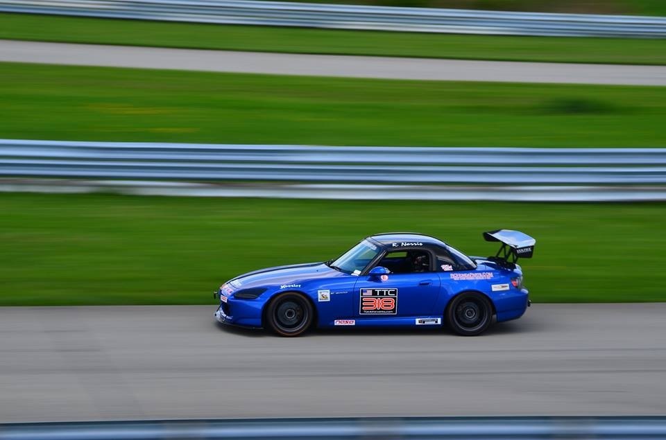

Mikey;
Thats my favorite s2000 color, but every time i see one it makes me mad. We cant get that color here in the US, unless we hijack one from canada, eh
Borderline thread jack, my current track toy

I apologize for an earlier post regarding these little cars (it was in bad taste) the mods removed my comments and advised me to offer condolences to those who have to drive them...
Now seeing a picture of one having never seen one in real, can you enthusiasts please explain what is so inspiring about it?...im asking why dont i have one? why am i not enlightened to the marvels of this machine...no seriously
The way i see it its a bit like a jonway scooter? cool to ride as long as you keep your helmet on? so know one recognizes you
You guys all have AM's and yet are raving about this key ring of a car? Im thinking if Im at the lights in my Range Rover sport and this thing is next to me i wont even know....and dont bother to go there ....the rangi will kill it robot to robot and top end i know its quicker than a 4.7 Vantage ... i know
only kidding boys just trying to wind some sensitive boys up

S2000s are great driver's cars. They handle very well and a lot of people race them. Miatas are similar in that regard - great handling cars that are great to race. Neither car has the power of a V8, but they're a great vehicle for the track. There are also a lot of amateur races people can drive them in. Plus you don't have the huge expenses of a full-blown race car. You get all the fun of racing at a fraction of the price.
