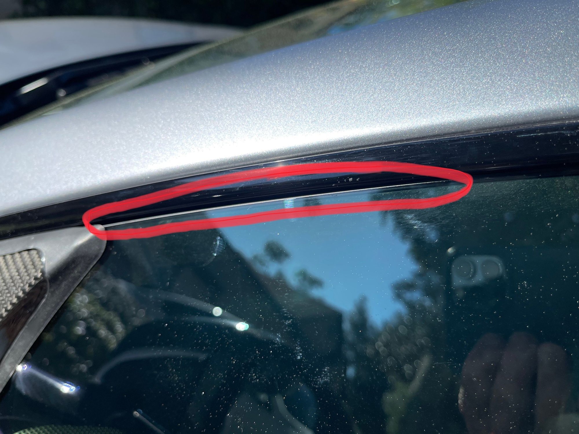

Dealer fixed it .. no issues until recently. I noticed glass rocks a little bit and allows wind into the cabin. There seems to be a hair line gap between glass and frame .. glass needs to go all the way under the frame. Window reset won't help. Glass may have dropped down a little bit and needs adjustment ... getting this taken care of next week at the dealership.

I regularly use Sonax or 303 or Gummi Pflege on all rubber seals. Replaced external mirror seals. Noise issue was fixed by dealer tech sometime back. Over time, glass seemed to have slipped a little bit and not going completely under the frame. This got nothing to do with doors rubber seals. Will post back after appointment.
