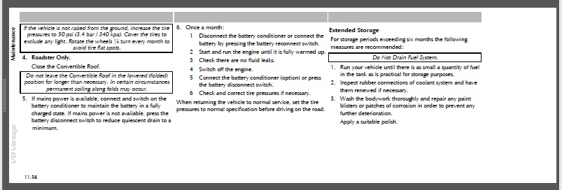

the owner's manual has a section on what to do to prep for storage. They recommend overinflating the tires. Also, don't forget when you go to start it the first time you need to press gas pedal all the way to the floor, and press the start button til the oil light goes out.

AM manual says to pump up to 50psi.
