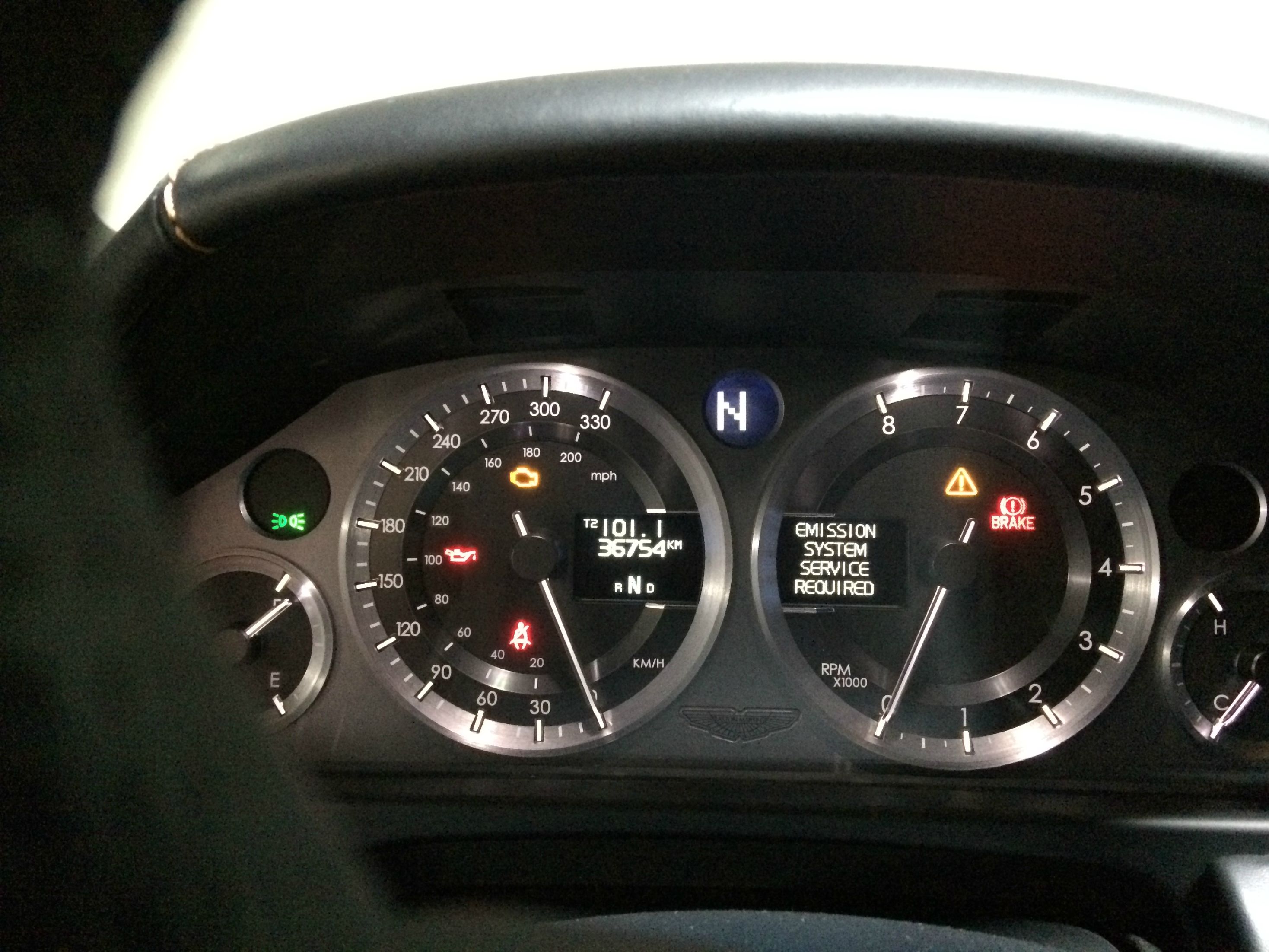

So today, new issue (doesn't seem to end with my car
Was driving in the city and all of a sudden got the " Fault No Gear Change Possible" RED error message.
Car stalled, stopped / started a few times to manage to get it to limp in 1st.
Now its parked and when I try to start the car I see "Emission System Service Required" and it won't turn over.
Battery seems fine, can turn on all eletronics etc it just won't turn over.
Anyone have this issue before?
http://imgur.com/ifMDKYu
I just had the clutch replaced in the summer...

Can you pull any DTC codes off it? We really need the number 1 Aston Martin Mechanic in the Americas to come advise!
The ASM cars won't allow the starter to fire unless they know the car is not in gear, similar to the manuals that have a switch to close the circuit when the clutch pedal is depressed. You mentioned 'limping' in first and stalling. Are you sure it hasn't stalled and stuck in gear? When you switch the ignition on, can you cycle through the gears at all?

Thanks for the reply.
I cannot cycle any gears, it always shows N. Its definitely in Neutral as I pushed the car into a parking spot by hand with some friends.
I'm going to have it flat-bedded to the dealer ... just frustrating this stuff happens so randomly, 2nd time this year
