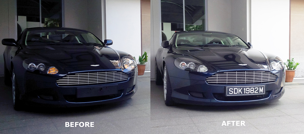

One of the recent DIY's I tackled was that of upgrading my headlight cornering light-bulbs. The standard PY27/7v-style orange bulbs 'reflect' this orange hue all over the blinker light area on the headlights. This doesn't give it the look it should have imho. With bad experience on previous cars with the chrome-covered bulbs, I decided to upgrade to LED instead.

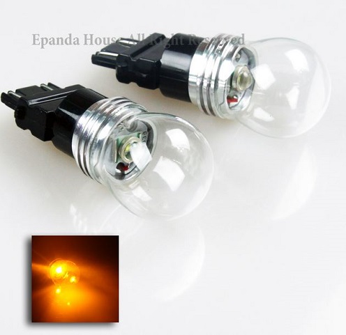

Because I'm not a fan of multi-SMD-led style bulbs (directional light and questionable quality), I further searched and found this single orange-led bulb which still has the glass-bulb incorporated enabling the light a 360 degree angle which replicates the OEM-bulbs 'shine'.

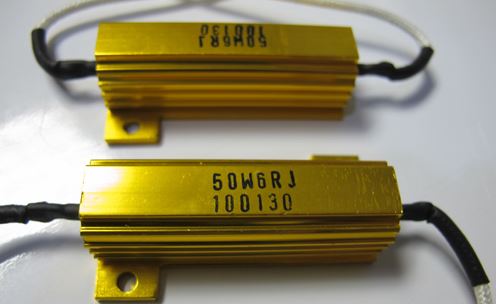

I bought them thru eBay and this search term "AMBER SMD 9W CREE CHIP 3157 DUAL FILAMENTS LED LIGHT BULBS" will get you where you need to be. Do not forget to order a set of 50 W 6 Ohm resistors to prevent rapid flashing and error messages in your instrument panel.

You have to take the wheels, inner fenders and air-filter boxes off: this is the only way to gain proper access to the lights. You need to remove the latter as well to allow the resistor to be placed correctly. I installed the resistors on the chassis-outriggers (just below where the corner-light-wiring runs) by means of pop-rivets and a lick of SikaFlex automotive sealant. They do get warm so make sure they're mounted to an aluminium surface. It's a simple connection of the two (2) wires to the two (2) wires of your cornering lights and off you go.
