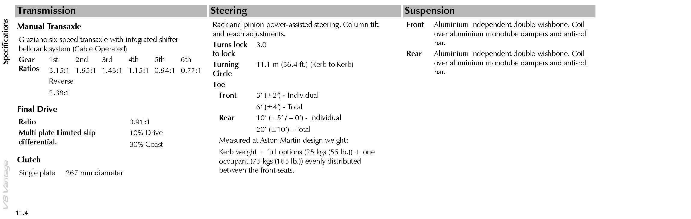

Interestingly the six speed manual transmission in my 2007 Vantage shows fifth gear at 0.94:1 and sixth gear as 0.76:1 (both less than 1:1)

Note that the current seven speed transmission in the corvette is an overdrive gear, for fuel economy only. Looking at the gear ratios on this transmission it appears fifth, sixth and seventh gears are all overdrive gears at less than 1:1.
Ironically, all six speed manual transmission cars that I have read about attempting top speed all attain said top speed in 5th gear.
