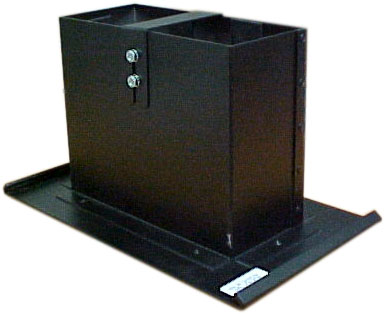

To make replacement easier - especially given how many times I removed the battery over the last couple months during designing, prototyping, and testing my lightweight mount - I cut a small notch out of the carpet trim piece. I only did a small section of the backing portion (the hard backside edge that doesn't have carpet on it) where the sliding clamp hits. This made removing the sliding clamps MUCH easier, but it's irreversible and if you mess it up, you mess up the carpet.

The lightweight kit installs the same way as the OEM battery - it retains the use of the sliding clamps. The good news is that you're not fighting the heavy OEM battery and the clamps at the same time. You can just set the base in its place and then get the clamps on it. Slide the clamps in place, then tighten them down. Then set your battery on the base, put the bracket over the battery, and bolt the bracket in place. Then hook up the battery. Button everything up, and you're done. The best part, though, is that next time you need to replace the battery, it takes 5 minutes. You pull the parcel shelf out, unhook the battery, undo the bracket bolts, and the battery lifts out without removing any of the carpet, trim, etc. You never have to touch the sliding clamps again unless you're removing the battery mount entirely.
I did look at doing a modular design initially, so other batteries would be able to fit. But cost, complexity, and strength would have all been compromised. Especially not worthwhile considering that this is a very low-volume product. So I chose a single battery that offers the best weight loss with lowest risk of accidental depletion.
