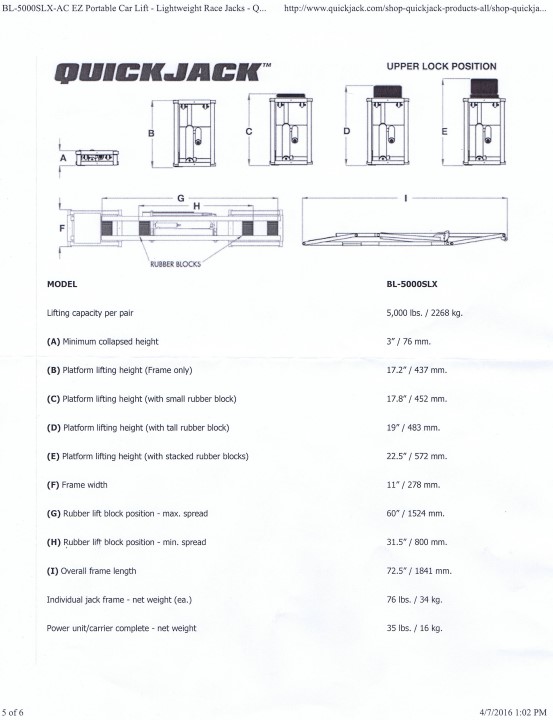

Here are the key dimensions of the 5000 lb model. I can't remember if the 911 guys said the blocks couldn't be moved close enough together or far enough apart to lift a 911. Supposedly the latest design works, but it's easy enough to measure the various distances and see if it fits.
Regarding stability, all I can say is that my set with my car on my garage floor is as solid as a rock. You have to have the it lowered onto one of the two locked positions, to use it in an intermediate position supported only by the hydraulic cylinder would be stupid and I can see in that situation there may be some slight wiggling if you pushed the car around.
Overall in my opinion these things are awesome and well worth the money.
Last edited by Jeff_335i; Apr 20, 2016 at 06:13 PM. Reason: Added photo of dimensions

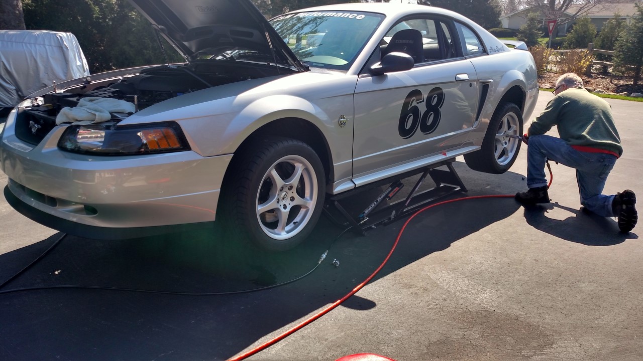

Hauled the Quickjacks over to my buddy's house today to work on his track car's brakes. The jacks fit in the back of my Jeep Grand Cherokee and are light enough that I could lift them in and out of the Jeep by myself.
The jacks including the taller rubber blocks fit under his lowered Mustang easily. Perfectly stable when raised. He sat in the car and ran the engine with the car up in the air. No problem at all.
I changed the 2 air filter on my vantage and it is so easy with this jack +1 for me

Would the 3500 lb version be enough? There's a place that has that for $835. The 5,000 lb version is $4-500 more. I don't want to die under it, but 3500 is about what the V8 Vantage weighs.
Old Apr 24, 2016 | 02:09 PM
telum01's Avatar
Posts: 4,366
From: NoVa
Rep Power: 295
With fluids and whatnot, a V8V weights 3550+ lbs. I'd err on the side of caution and get the 5000-lb version

Like Telum01 said I decided to go with the 5000lb version to be on the safe side... I think everything is the same between the 3500 and 5000 except for the hydraulic cylinder. With the 5000lb version I am safe to lift just about any cars except for a friend Tesla S which is about 5000lb :-(

Yes, definitely go with the 5000 lb version. Besides that, the units you see for $800-$900 are old versions that don't have all the latest improvements like the better hydraulic couplings (earlier ones leaked a bit when disconnecting), the longer rubber block trays, cams on the support locks for easier lowering, and even the little wheels on one end of each lifting frame.
