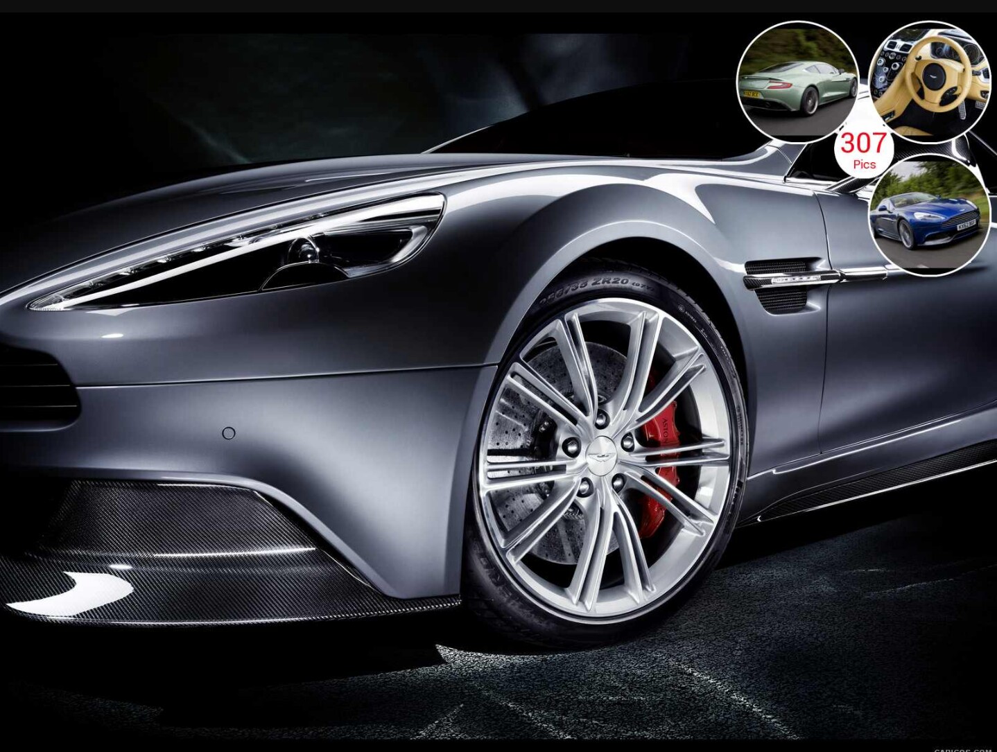

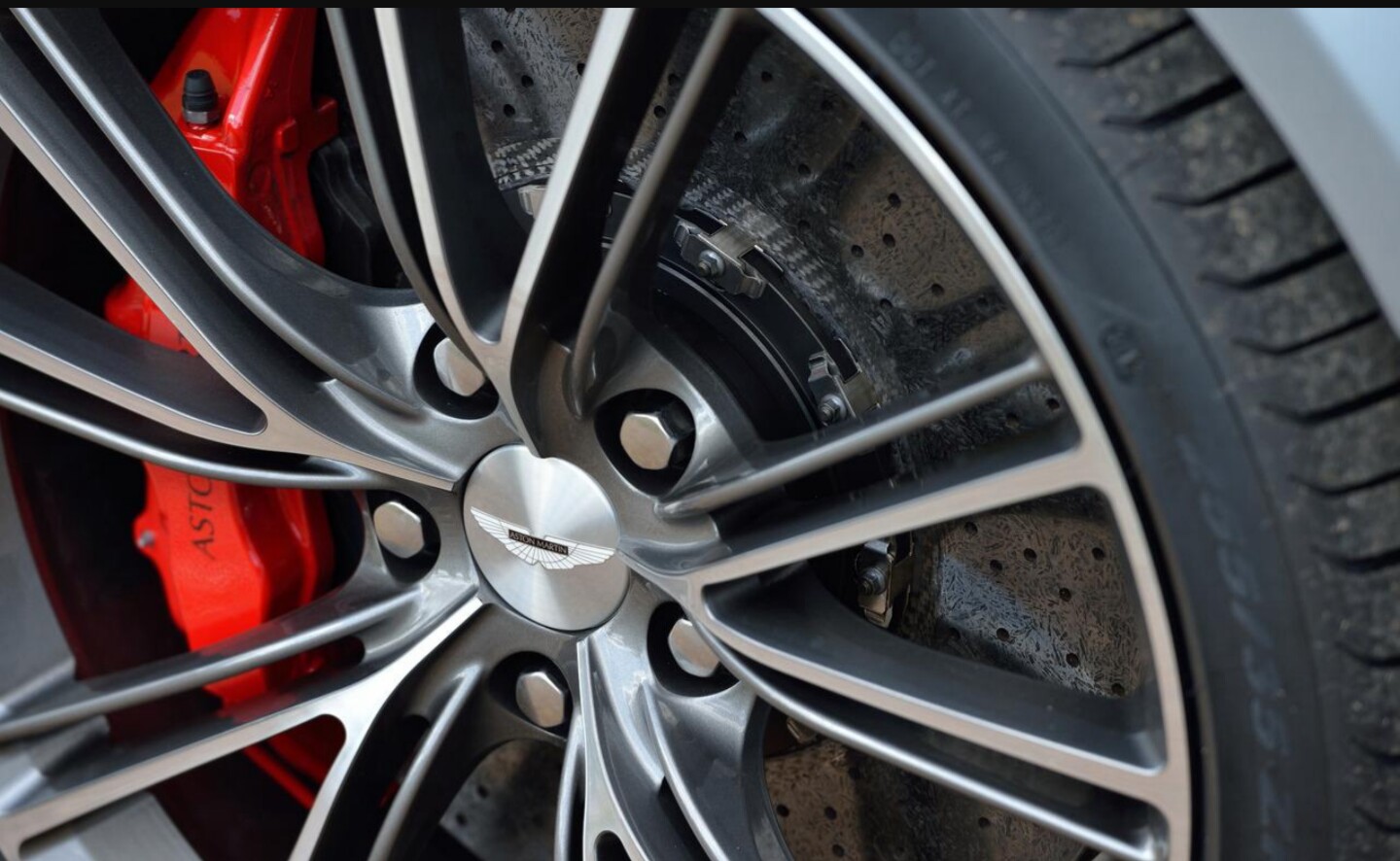

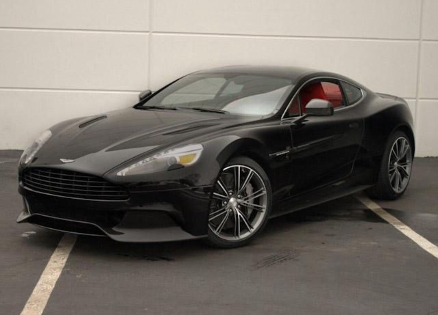

Has anyone seen this done?
I've been acquiring a used set of Vanquish wheels over the past few months. Buying them one at a time as I've located them but in need of "restoration" as my plan is to change the color anyways to a charcoal grey with a fresh diamond cut surface. I've only seen these wheels in gloss black or silver with diamond turned face. Neither of which I'm really crazy about for my Storm Black DBS.
Seems like the offset shouldn't be a problem however they're a half inch wider in both front and rear as compared to DBS wheels. It "looks" like everything will fit just fine and my tires shouldn't be a problem either.. Unless I'm missing something?
I really love these wheels and although the DBS is already absolutely gorgeous, I think they'll give it a bit of an updated look. The larger openings between the spokes will make the beautiful carbon brakes more visible and the wheels really have a more modern appearance.
Thoughts? I'm getting ready to drop these off at my wheel guy for fresh powder coat and resurfacing. I'd love to hear some opinions.
Thanks, Eric

I thought the bolt pattern was larger on the Vanquish wheel than the DBS/DB9. Have you actually fit a wheel to check?
Old Aug 20, 2016 | 12:02 PM
hkg1997's Avatar
Joined: Feb 2016
Posts: 47
From: SF bay area
Rep Power: 12
hkg1997 is infamous around these parts
I believed the bolt pattern on Vanquish is different from DBS??
Old Aug 20, 2016 | 12:12 PM
J doubleU's Avatar
Joined: Mar 2013
Posts: 2,428
From: So Cal
Rep Power: 262
J doubleU Is a GOD !J doubleU Is a GOD !J doubleU Is a GOD !J doubleU Is a GOD !J doubleU Is a GOD !J doubleU Is a GOD !J doubleU Is a GOD !J doubleU Is a GOD !J doubleU Is a GOD !J doubleU Is a GOD !J doubleU Is a GOD !
5X128 on a gen 2 Vanquish. DB9/DBS 5X114.
Old Aug 20, 2016 | 12:21 PM
speedracer800's Avatar
Joined: Jun 2010
Posts: 800
From: Lake Geneva, WI
Rep Power: 52
speedracer800 is a glorious beacon of lightspeedracer800 is a glorious beacon of lightspeedracer800 is a glorious beacon of lightspeedracer800 is a glorious beacon of lightspeedracer800 is a glorious beacon of light
Oops.. Anyone looking for some Vanquish wheels??
I thought I read they were the same bolt pattern. (red face) wow.. Lol
