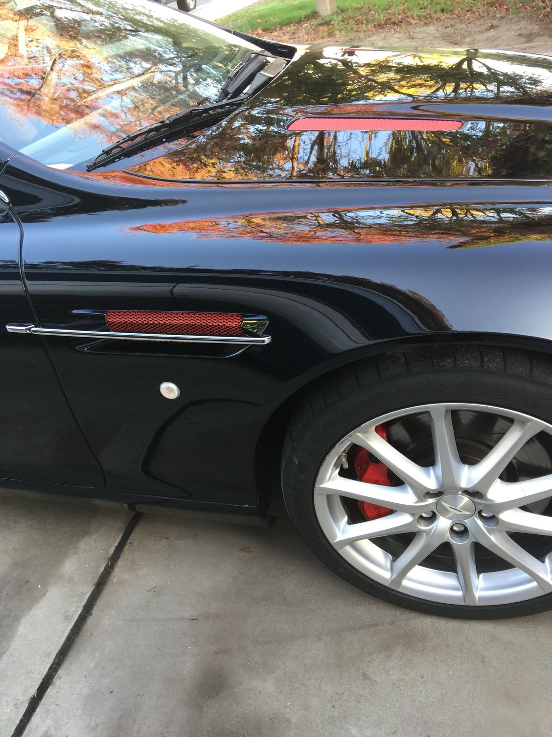

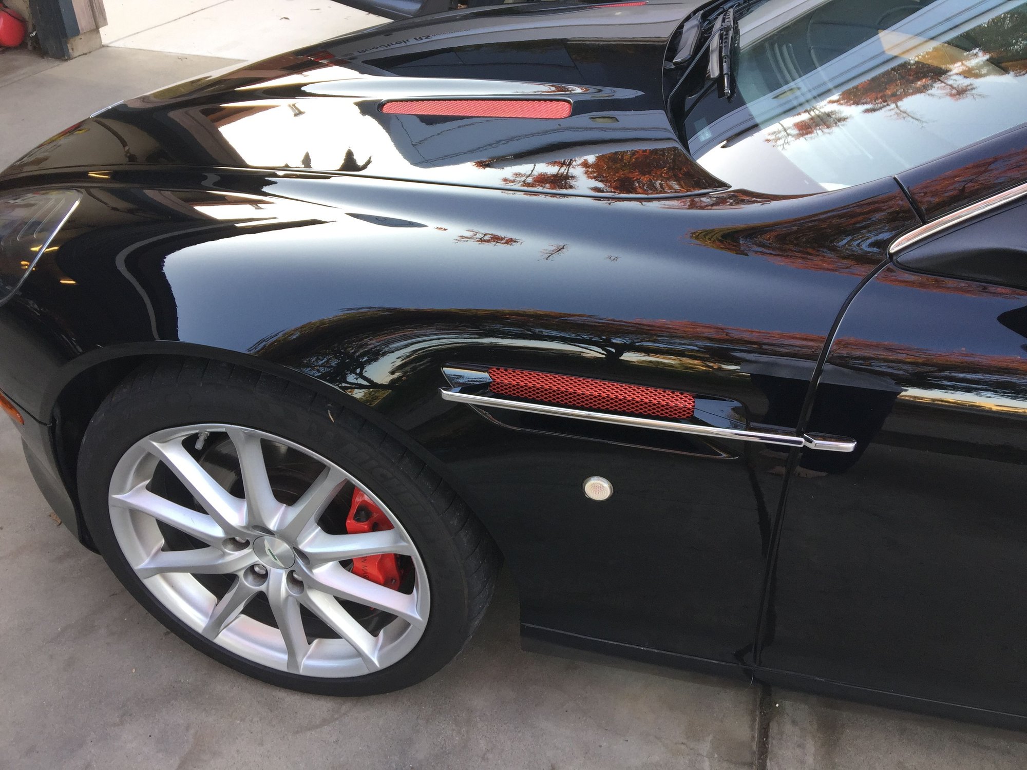

Here's a couple pics of mine. And yes it's not the exact shade/tone/whatever as the calipers. I painted the cross braces and center manifold plate on the engine too. Can see them in my sig pic to the left. Probably a $5000 bespoke option from the factory for the price of a can of spray paint. Actually the cross braces were done with plastidip so I could remove it if I didn't like it. So with the spare pieces from Aston Bits and Plastidip the whole thing is reversible.
Going to get the wheels redone in a darker shade so they hide the brake dust a bit and I don't have to wash them so often.

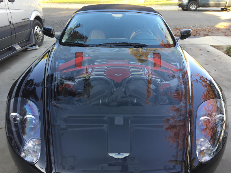

Here's a shot inspired by Mathman85 in the Official Aston Martin Picture thread
Old Nov 26, 2016 | 11:02 AM
era2076's Avatar
Joined: Oct 2016
Posts: 479
From: Eagle Creek Or
era2076 is infamous around these parts
Beautifu,l but a bit brite for me. We are shooting everything black. A smoked poly carbonate hood would be cool. That pic looks fantastic.
