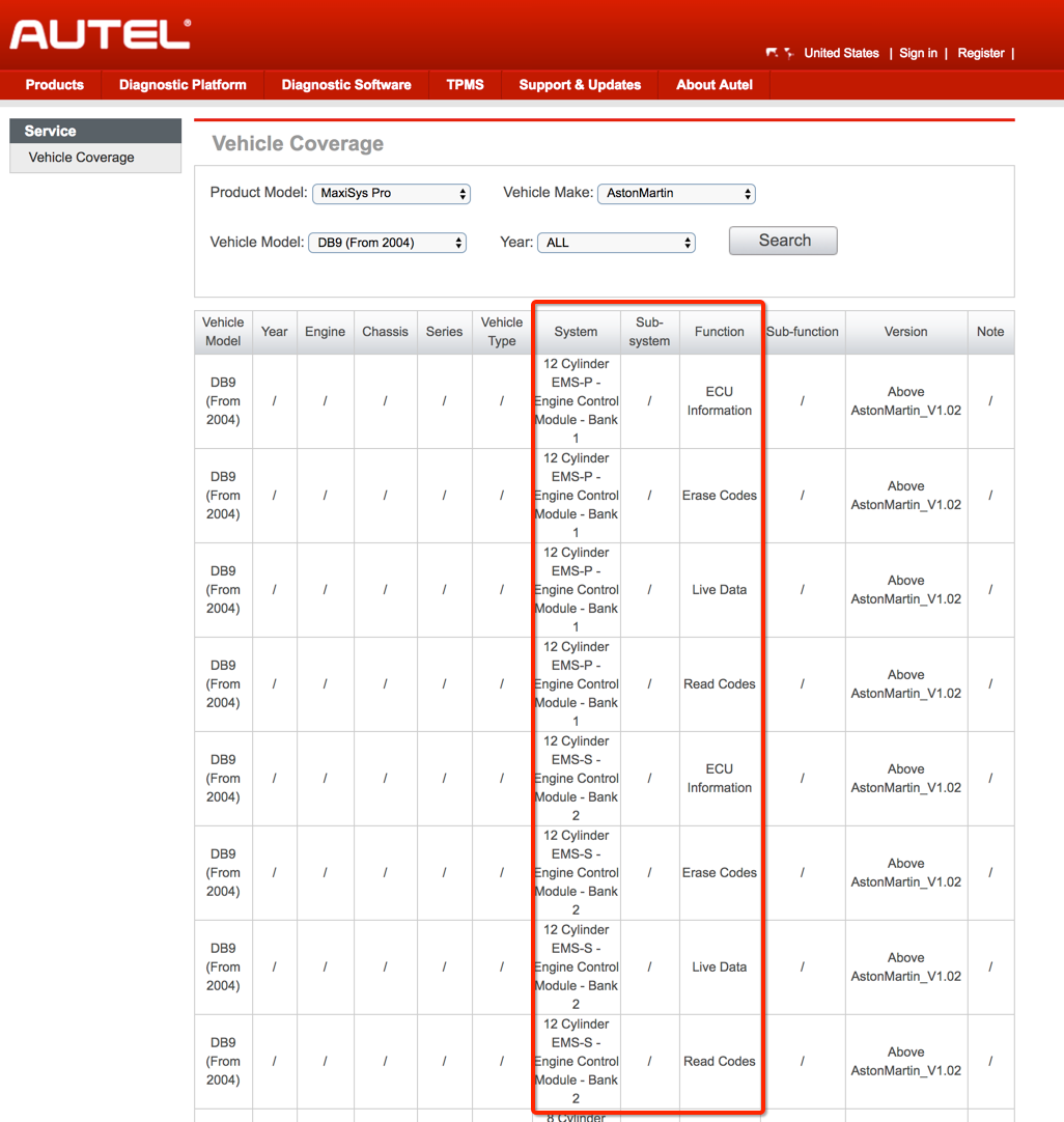

Saw this thread as I was researching diagnostic equipment for a 2015 Aston Martin DB9. I know it's an older thread but I wanted to post what I found researching the Autel. Also, if anyone who purchased one has an update on how it performed (or didn't perform) that would be helpful to hear.
It seems like they continue to support / update it as they are on the 2nd version of their AM software (AstonMartin_V1.02). Here are the release notes from V1.00: https://www.auteltech.com/u/cms/www/...031943f8vc.pdf.
I haven't been able to find the release notes for 1.02 but you can pull up the car coverage at the following link and see all the modules (and function Erase, Live Data, etc.) for each car https://pro.auteltech.com/measurecar...ype=5&pageNo=0
Modules and functions
Cheers!
