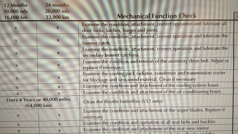

Old Apr 5, 2017 | 12:55 PM
Prefurbia's Avatar
Joined: Aug 2013
Posts: 1,936
From: Minneapolis
Rep Power: 111
Prefurbia has a reputation beyond reputePrefurbia has a reputation beyond reputePrefurbia has a reputation beyond reputePrefurbia has a reputation beyond reputePrefurbia has a reputation beyond reputePrefurbia has a reputation beyond reputePrefurbia has a reputation beyond reputePrefurbia has a reputation beyond reputePrefurbia has a reputation beyond reputePrefurbia has a reputation beyond reputePrefurbia has a reputation beyond repute
I was told that there is a service bulletin that the cable to the latch needs to be adjusted at annual inspection to prevent the possibility of the hood flying open - I got that info from an Aston mechanic. true or not - I don't know.
Old Apr 5, 2017 | 02:01 PM
J doubleU's Avatar
Joined: Mar 2013
Posts: 2,428
From: So Cal
Rep Power: 262
J doubleU Is a GOD !J doubleU Is a GOD !J doubleU Is a GOD !J doubleU Is a GOD !J doubleU Is a GOD !J doubleU Is a GOD !J doubleU Is a GOD !J doubleU Is a GOD !J doubleU Is a GOD !J doubleU Is a GOD !J doubleU Is a GOD !
It's on the annual maintenance sheet?
