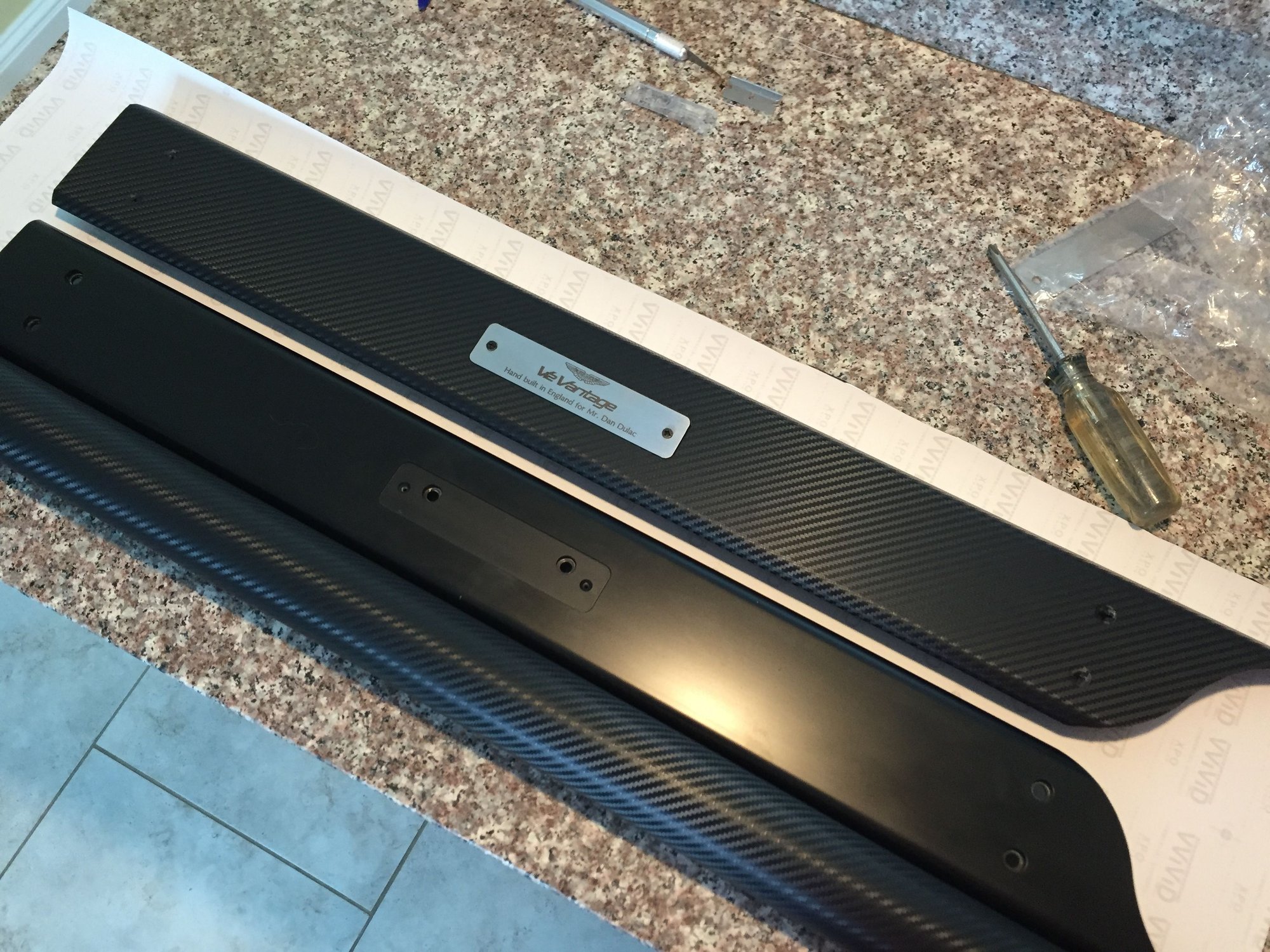

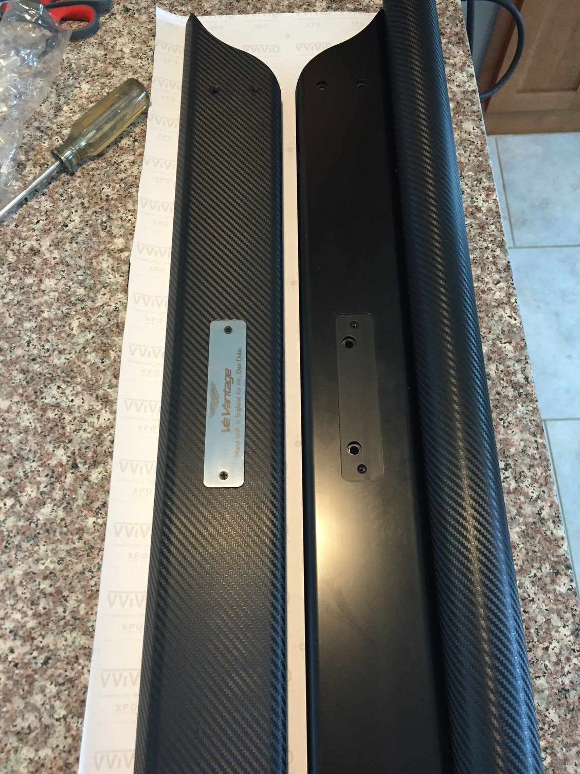

I decided to wrap my aluminum door sill plates with dry carbon fiber wrap with my personalized logo'd plates...I'm very happy with the results. It was my first time working with vinyl wrap and it's pretty forgiving. I just took it slow and made relief cuts around complex/curved corners and used a heat gun to apply some shrinkage and get the adhesive to activate; worked great.
Not only do I think this looks good, it will provide scratch and scuff protection of the soft aluminum sill plates when getting in/out of the car.
Here's a pic of one side done compared to OEM:

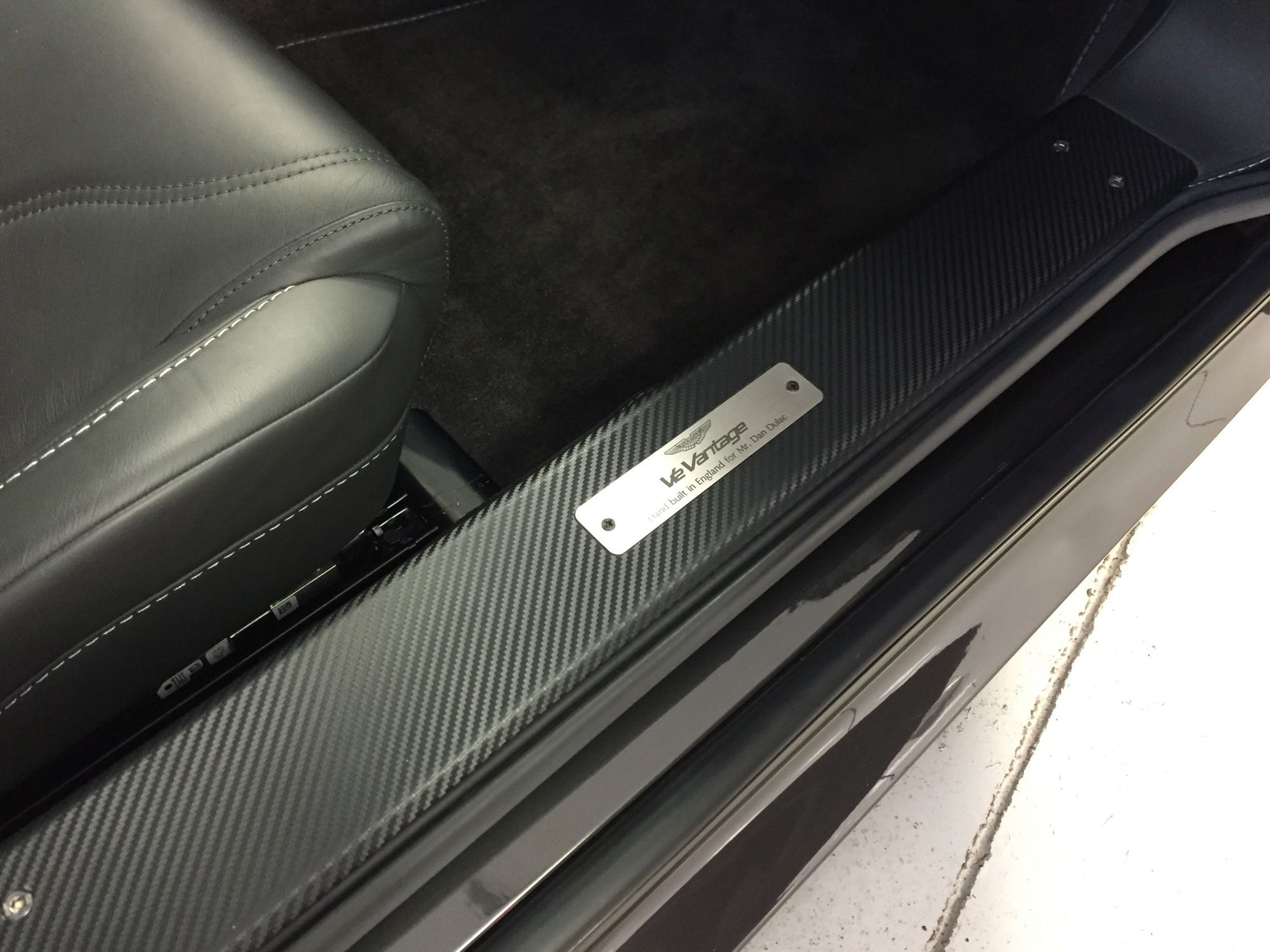

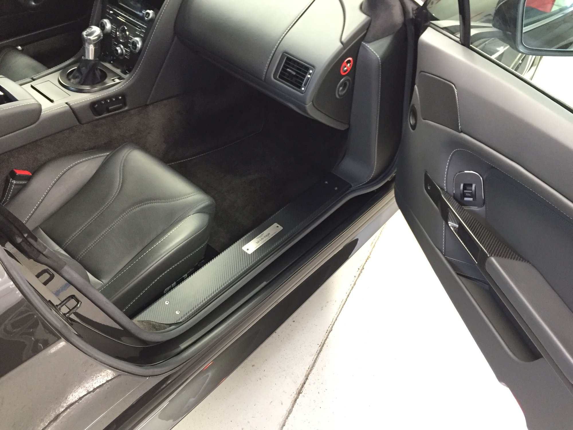

And a few pics of the finished product:

Looks like a matte finish. How does that compare to your door arm rest which is actual CF?
This gives me a thought. Could I get my front splitter and rear difusser covered in glossy CF wrap and would it have an authentic look? Even if could be done (wrap adhering to plastic) I wonder, since I have later V8V difusser, if the exhaust tips would either melt the wrap or worse catch them on fire!

It's pretty close to the door pull but not an exact match. The door pull is a tad darker. With the door open, you really don't notice the difference; have to study it closely.
Glossy wrap rap would look great for the exterior parts. Give it a shot!
