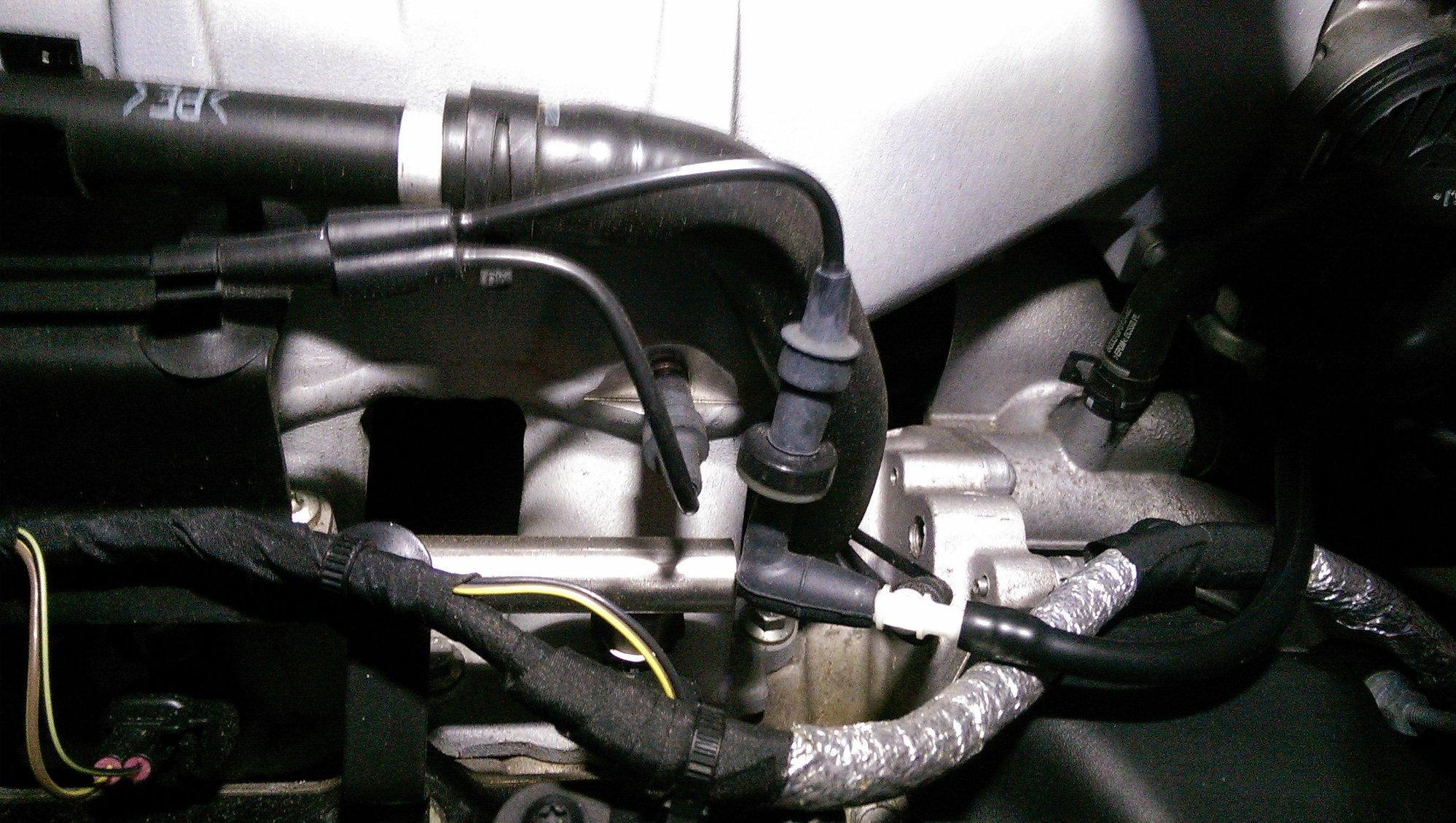

The intake manifold is not black and does not have the extra vacuum nipple, but I did find vacuum lines zipped tied to the intake tubing that goes down towards the air boxes. It appears those lines are fed by a T off a vacuum line on the passenger side of the intake. So I suspect that AM came up with a different way to retrofit the S airboxes onto a non-S car. Here's a pic of where the T is on the right side of the manifold. The vacuum line heading off to the right feeds the lines following the intake tubing.
