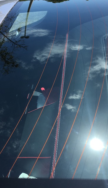

Thanks everybody for your responses. Here is a picture of the parcel area ... it is clearly visible red stitching is faded to pink and becoming white. I do leather treatment myself with Aston Martin Leather Care which comes with leather cleaner solution, leather softener solution and protection cream.
Another issue that I noticed is ... side view mirrors which make whirring noise and start shaking. At first they were lubricated, second ... working as designed, third ... waiting for replacement.
If that is the only area where the stitching is being a pain, then it is one of two things:
1. SUN is fading it----- get your windows tinted and that will help with that, AFTER you have AM replace the part
2. Whatever window cleaner was used on the back window, is having a chemical reaction to the RED stitching and causing it to bleach out. Could be ammonia, or some other chemical. Way forward is to spray the cloth first, then wipe the window rather than spraying the window which caused the cleaner to fall onto anything below.
Those are your two causes, one or the other.

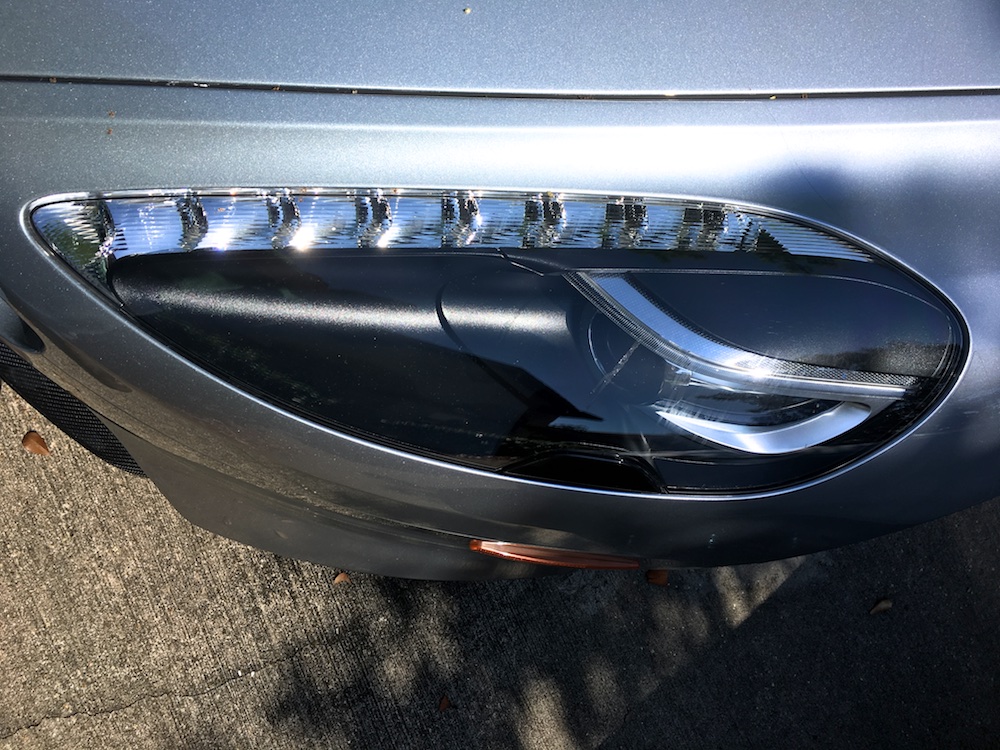

Stains in headlights
An update .... tail lights and exterior (side view) mirrors were replaced. Exterior mirrors (open/close) have become very noisy ... they sounded like a power generator is running. I am glad they were replaced ... very smooth mechanism now
Another annoying thing I noticed .. stains in both the headlights I have no idea how it can happen. Please see the picture here. Any thoughts ?
