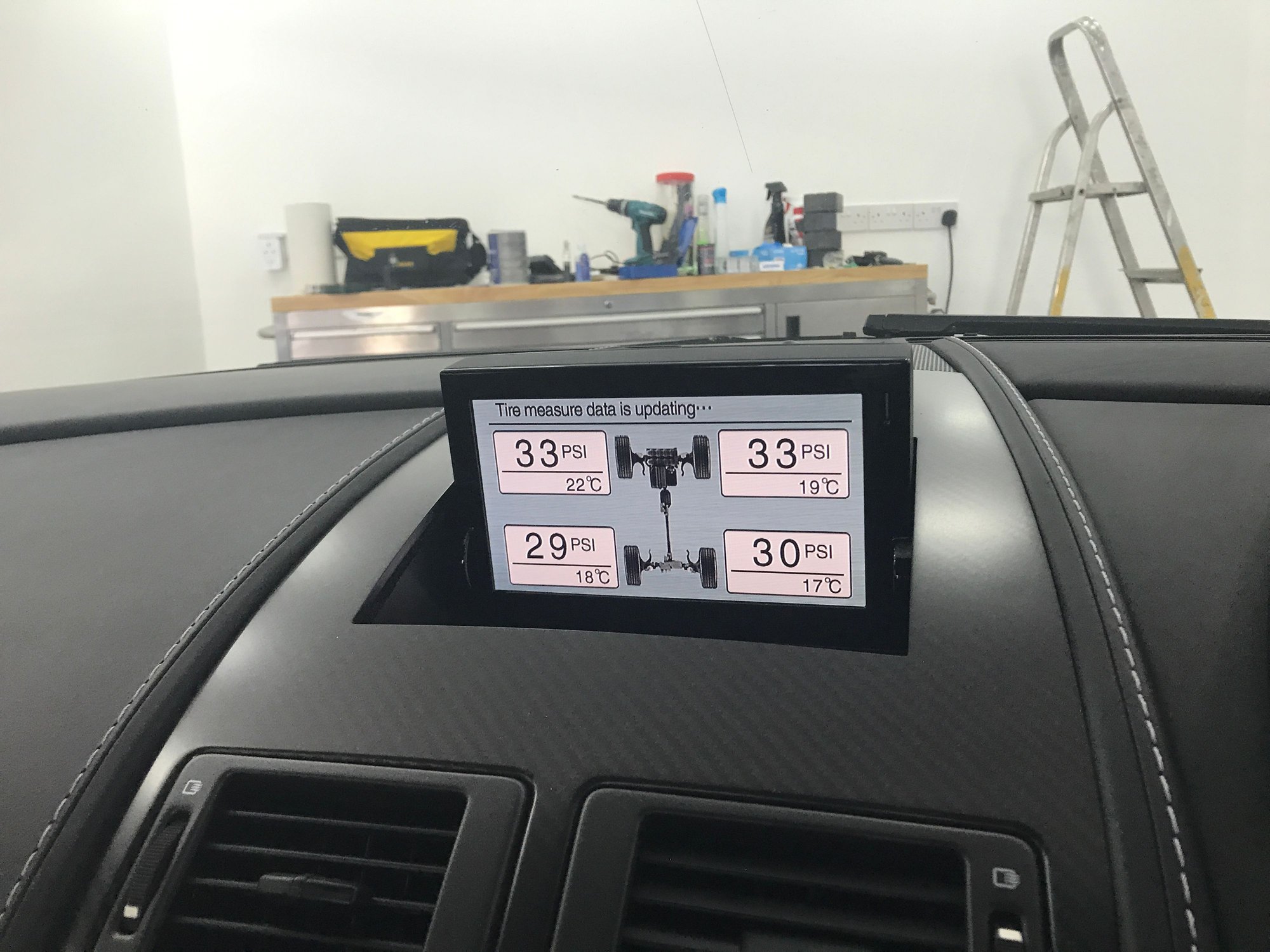

You sure it isn't smarttire?
i have a 2013 V12V, it was smarttire. I've just had the whole system replaced.
