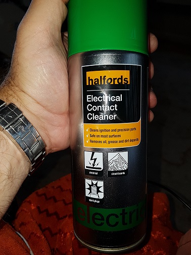

Thumbs up Electrical contact cleaner and a toothbrush = Resurrection
For those interested the ECU is back from the dead. A liberal application of Electrical Contact Cleaner, working the buttons a number of times and a light scrub with a toothbrush has resolved the issue.
