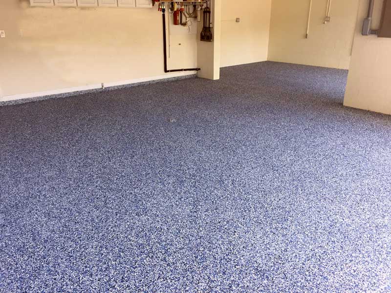

My garage floor is coated with an epoxy layer (see picture). I am concerned that my current floor jack with wheels will damage the floor surface.

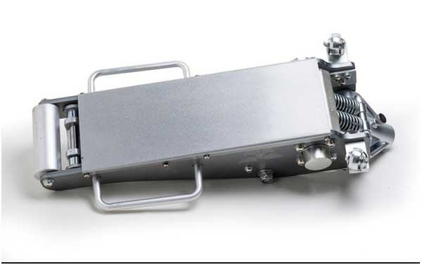

I have been looking for an aluminum, low profile jack that would spread the cars weight over the floor, with a low enough saddle to go under the Vantage.
I have finally found a jack (on line) that might meet my requirements. It has a flat bottom and the unit is made out of aluminum.
It’s manufactured by Pro Eagle Products,
Is anyone familiar with it? Does anyone know of a floor jack that meets my requirements?

As the jack lifts it will move towards the car. If the jack doesn't have wheels it will either slide on the floor or the car will slip off the jack. I'd bet that this jack will do more damage to your floor if it slides than the wheels would. Why not just place a wheeled jack on a thin plate of steel?

Yeah, if the jack doesn't have wheels to re-position itself as the car goes up, you're gonna create more problems. What good is an epoxy coating that can't hold up to a floor jack's wheels?

The jack you posted is not flat - it has a roller on the front and two wheels on the back. The jack must slide forward and backward as it pushes the car up. If not, the car will tip off the jack.

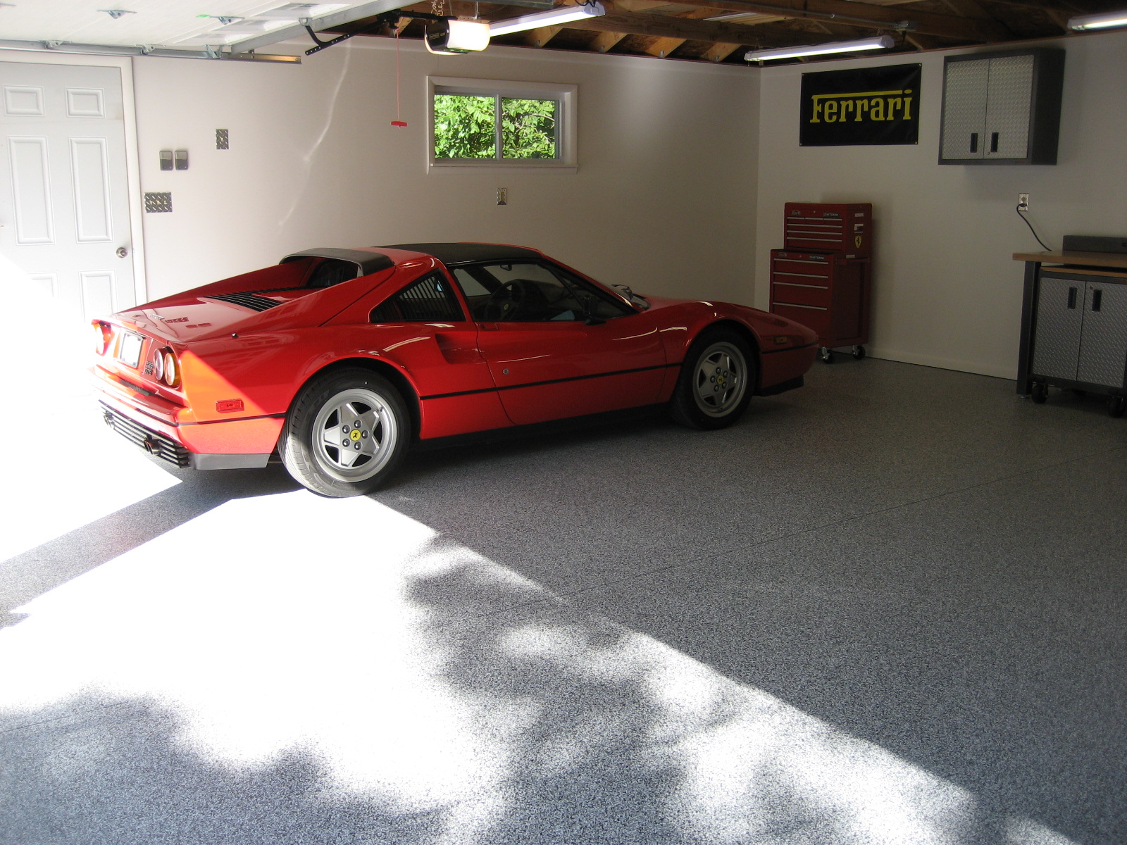

I have an epoxy floor in my garage and have used a regular wheeled floor jack on it for 10 years without damaging the floor.
