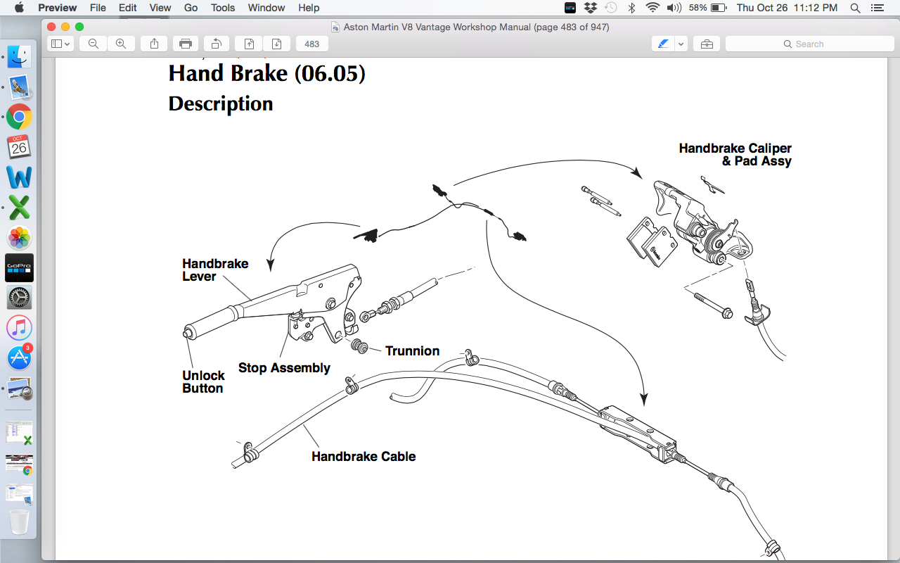

Here is what's in the service manual...hopefully you can see all this...Looks like from the nomenclature there is a "switch" in or near the handle assembly.

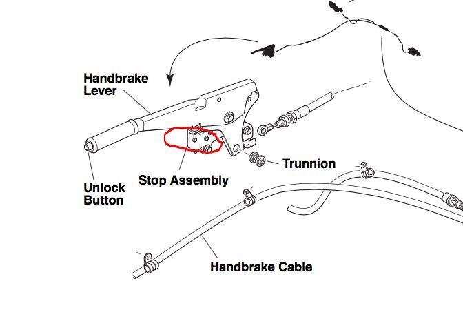

As you both pointed out there appears to be a micro switch on the handbrake assembly. It seems like my switch has come apart as it appears to just be a square black plastic hole with a spring in its center and a wire connected to it.
The switch sits on the outside of the assemply in your pic and is secured by the 2 screws i've circled in red in the attached pic.

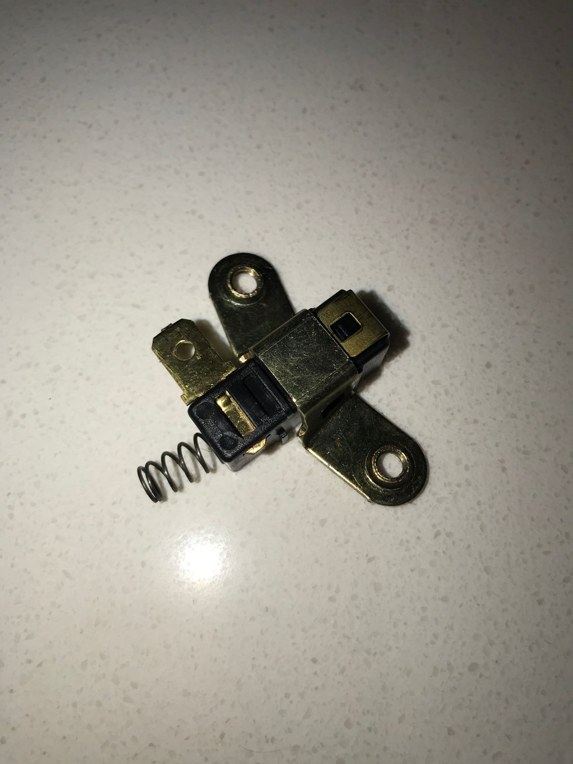

I guess it is this part:

Yip that’s the part. I stripped it out last night, I’ve attached a pic of what it looks like now. The top of mine seems to have broken off and I can’t find the pieces anywhere in the car.
I called Aston yesterday and they say it can take up to 20 working days to get it here! So I did some searching on the net and discovered Land Rover uses the same part so I’m hoping one of our local dealers will have stock.
