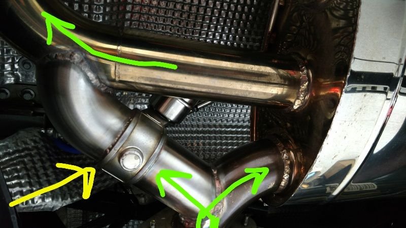

I wanted to create a remote controlled bypass to route exhaust around the silencer in my DBS. It was important to me that I used as much of the cars original equipment for controlling the valves as possible.
The original "stock" silencer of course came equipped with a pair of vacuum controlled bypass valves but my Tubi aftermarket silencer wasn't equipped with this so I first had to create this. I sourced some vacuum controlled valves online and then figured out a location on the silencer to fit the valves and bypass pipes. See pictures.
The other pictures shows a yellow arrow indicating the valve and bypass pipe I fit and the green arrow indicates the flow of the exhaust gas to help show you how it all works.
I found a company called "cccharger.Co.uk" They created a very simple kit that enables the exhaust valves to be open and closed using a remote control. Clive helped me modify his kit to operate a bit differently to allow me to open and close my valves at any RPM.
I made a quick video today showing the exhaust in both open and closed position. About halfway through the video you'll hear the tone change when I pushed the button on the remote to open the valves.. Again using the cars original compressor. I think it sounds terrific and gives me the best of both worlds.

I think it would sound a lot like my video with the valves open (silencer bypass mode).
I should have mentioned that my car is equipped with Velocity secondary cat bypass pipes also which obviously gives the car a lot more aggressive noise. After trying the Xpipe and H-pipe I like the straight cat delete pipes the best.
