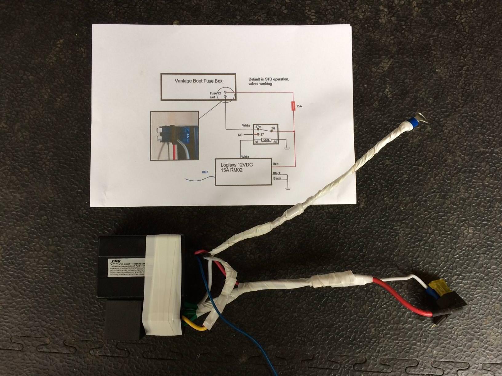

Make an Aston Martin IED!
Exhaust Flaps normal operation when you start the car.
Push remove button to open all the time
Win Win
