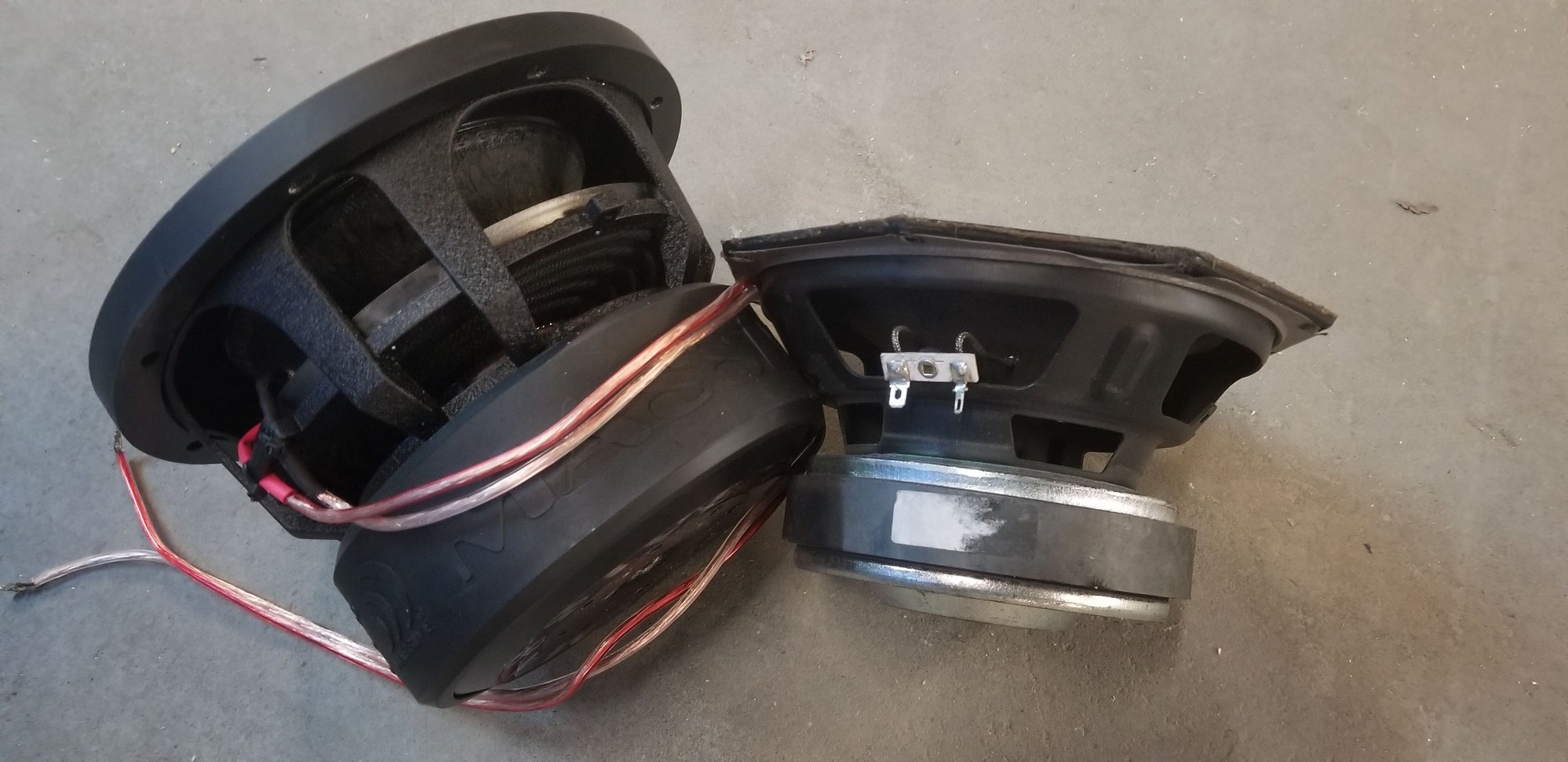

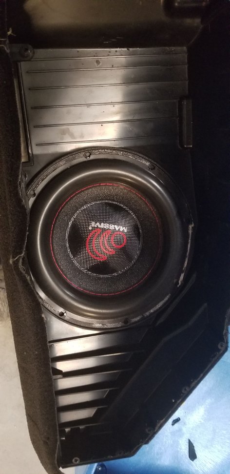

First let me state the sub I chose is huge. I have to modify the sub box significantly to get it to fit, and to add needed volume. Upgrading subwoofers in the stock band pass enclosure is a compromise at best, dismal failure at worst.

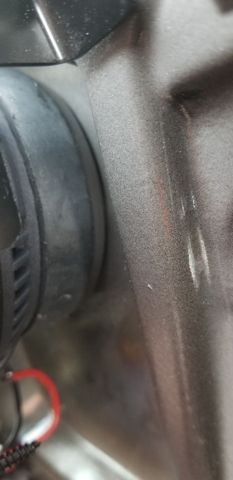

I had to trim 1/8" off one edge of the sub frame to get it to slide in. I also had to make 2 small notches in the stock hole.
Since the woofer is 5.75" tall, I had to make a .25" spacer to raise it up. Easy enough, I took the rubber sealing ring and moved it below. I also had to take the rubber boot off thre magnet assembly to give enough clearance to message thre sub in.
Close up showing seal ring below speaker rim.
To add volume in the ported chamber, I cut the top cover, removing the area that holds the spare bulbs and tow hook. I then cut a piece of 1/2 plywood for a new top. Screwed it in and sealed with silicone.
Tonight I finished everything except the plywood top. Even with the ported chamber wide open its it's a huge improvement, and that's with the stock amp. The stuck sub tended to be tuned in too small a band and was in effect a one note wonder. Sealing it back up may create the same situation. If so, I'll open it back up.

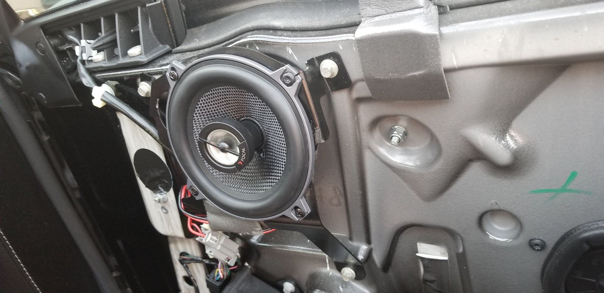

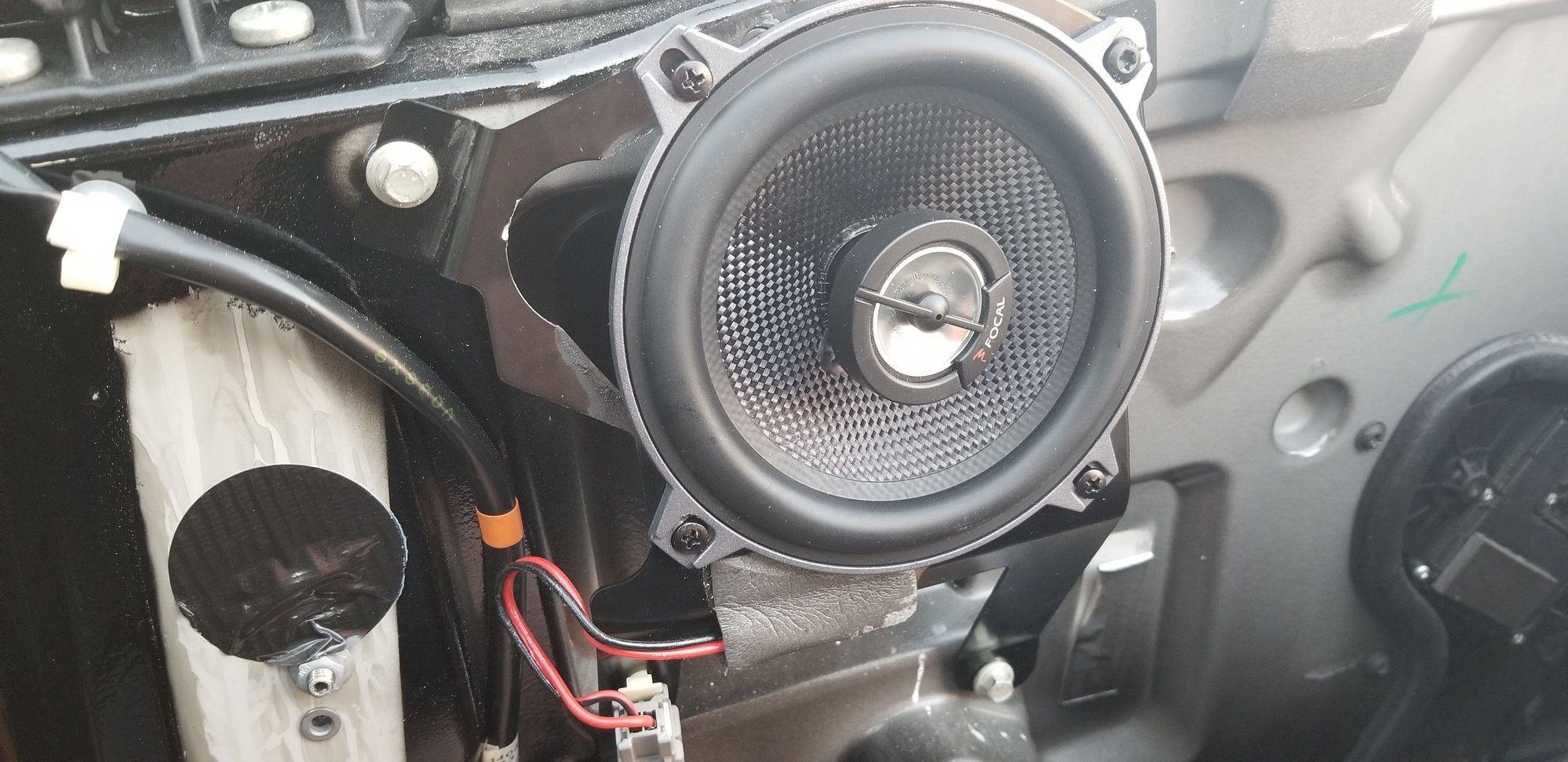

Got the 5.25" door speakers in. Fairly straight forward to hog out the stock hole. Used upper right original screw hole, drilled 3 new holes.
One note, the speaker depth prevents the speaker frame from going alk the way back on. You can still tighten it up until the magnet is snug against the door. Door panel clears fine. Just take the 4 bolts in evenly a little at a time, being careful not to bend thre speaker frame.
