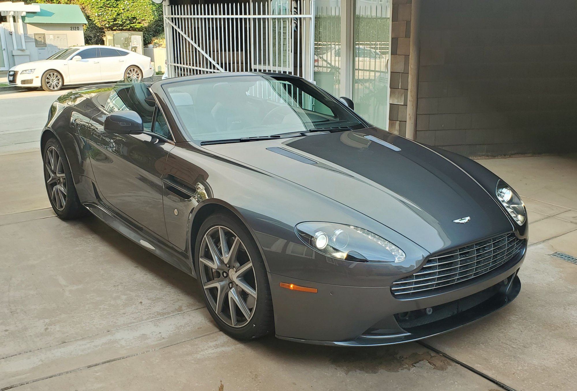

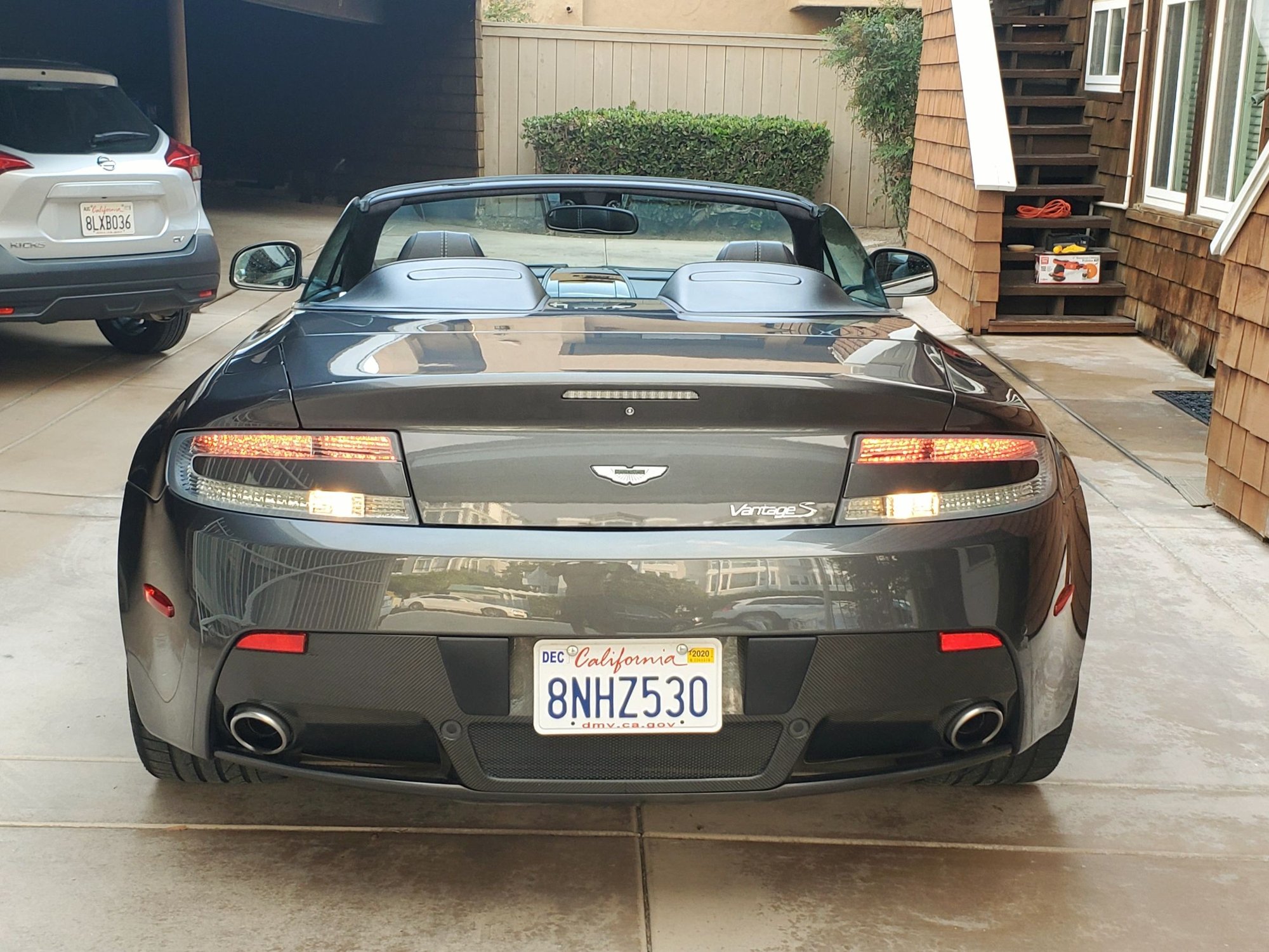

On another note, we managed to do a quick 250$ fix . The leak was close to the clamp so a local guy cut a couple inches of the hose, pulled it and clamped it. No leak so far. Not sure what the implications are for a shorter hose , but should the tranny be dropped in the future for some other job, I will replace the whole time .
Washed it today and it is looking good

Nice job, the hoses are low pressure so it should be ok. Why they are not a quality hydraulic hose that should last 10 years is ridiculous.
