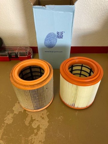

When searching for the OEM air filter parts to prepare for the job (4G43-9601-AB-PK) something cropped up from a company called Blue-Print. I had never heard of Blue-Print before but the filter looked identical in pictures. I did a little more digging and it turns our that this brand is actually Bilstein.
The set was a lot cheaper and Bilstein is generally a reputable manufacturer, so I took a chance and ordered it. There were no US sources I could find but a number of sellers on eBay shipping out of the UK.
I replaced the air filters on my car this weekend (what a job!) and had a chance to compare them side by side. If not for the part numbers and the dirt, you wouldn't be able to tell them apart. Looks to be a high quality part and made in exactly the same way as the OEM but at 1/3 the cost. Final tally for the Blue-Print filters was $49 including Fedex shipping from the UK vs over $150 + shipping for the AM version.
The only issue was that they are a pretty tight fit and I needed to stretch the filter opening a little to get it to pop over the flange on the end of the intake tube.
The Blue-Print part # is: ADJ132232

I have a set of those. They were so tight, I held off and bought a set from Red Pants instead...
They are just as tight. I would say they are identical...

i bought a set of these on ebay at the price mentioned. in my case they were mailed from riga latvia! (i'll be adding another country to my 'ebay sellers' list. ) and yes they are tight. a little swipe of grease on the inside of the opening did the trick. they looked identical to the original (!) 2007 air filters that were on the car when i purchased it with 11,000 miles on the odometer.

no complaints from me... i should mention that when i put on the second one (after about a six month recuperation period from putting on the first one ) the car stumbled for a few seconds on startup for the very first time. within seconds it was running as good or better than ever. i suspect the induction system was adjusting itself to proper breathing again, inasmuch as that second filter i removed (after 15 years of use) was pretty filthy.

No issues after this many months and several thousand miles. Car runs great and fuel trims are very near zero, so all seems to be in good health.
*disclaimer* I have not physically opened up the air box again and inspected them but as it stands today, I would not be afraid to use the Blueprint brand again.
