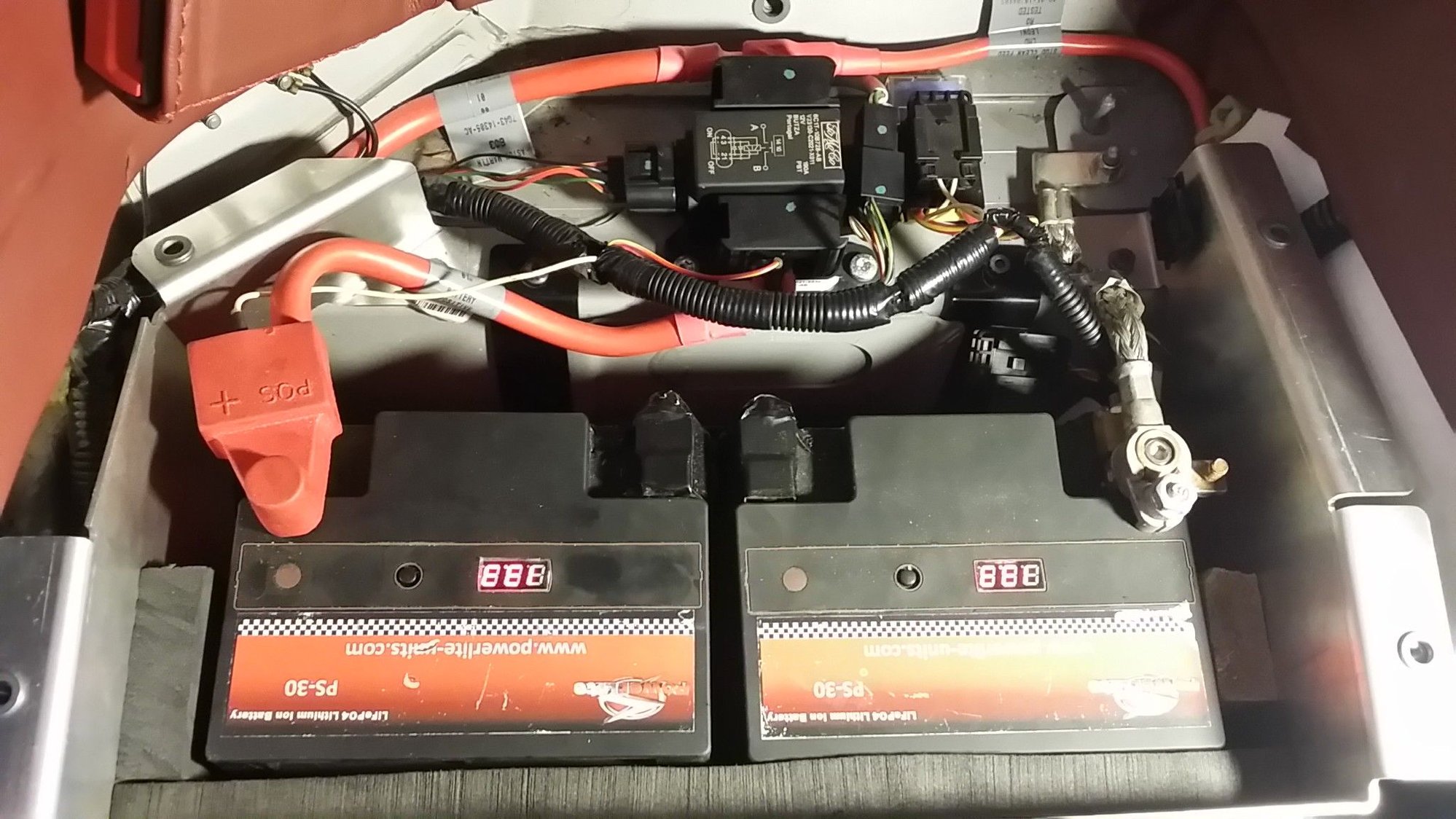

Two PS30 (2x30Ah) for my V12 since two years without any problems ! Save 17kg
https://www.powerlite-units.com/lith...tteries.html#2

How do these work with the battery tender/conditioners? Can you use the OEM unit that goes into the cig lighter?
Old May 3, 2021 | 08:33 AM
Phil57DBS's Avatar
5 Year Member
Joined: Jul 2018
Posts: 94
From: France
Phil57DBS is infamous around these parts
No problem with my OEM cigar/lighter in the trunk.
one specific Lithium tender/conditioner is provided with every Battery
see website
https://www.powerlite-units.com/file...heet_PS-30.pdf
Just looking at the weight of 2.7kg immediately tells me it's not 30Ah. A 30Ah 4S LFP pack weighs about 5kg. They're sneakily using "Pb equivalent rating", you actually have 2 16Ah packs for 32Ah total. That's solid, but I think you overpaid a little. On a v12 I would personally want at least 40Ah for a car that isn't daily driven.
A good way to get 40Ah in the USA if you're willing to put up with the trouble of making a battery tray is two of these: https://www.batteryspace.com/lifepo4...assed-dgr.aspx
A car battery isn't being cycled like crazy so LED balancing is okay. The cells are high quality and high C-rate.
