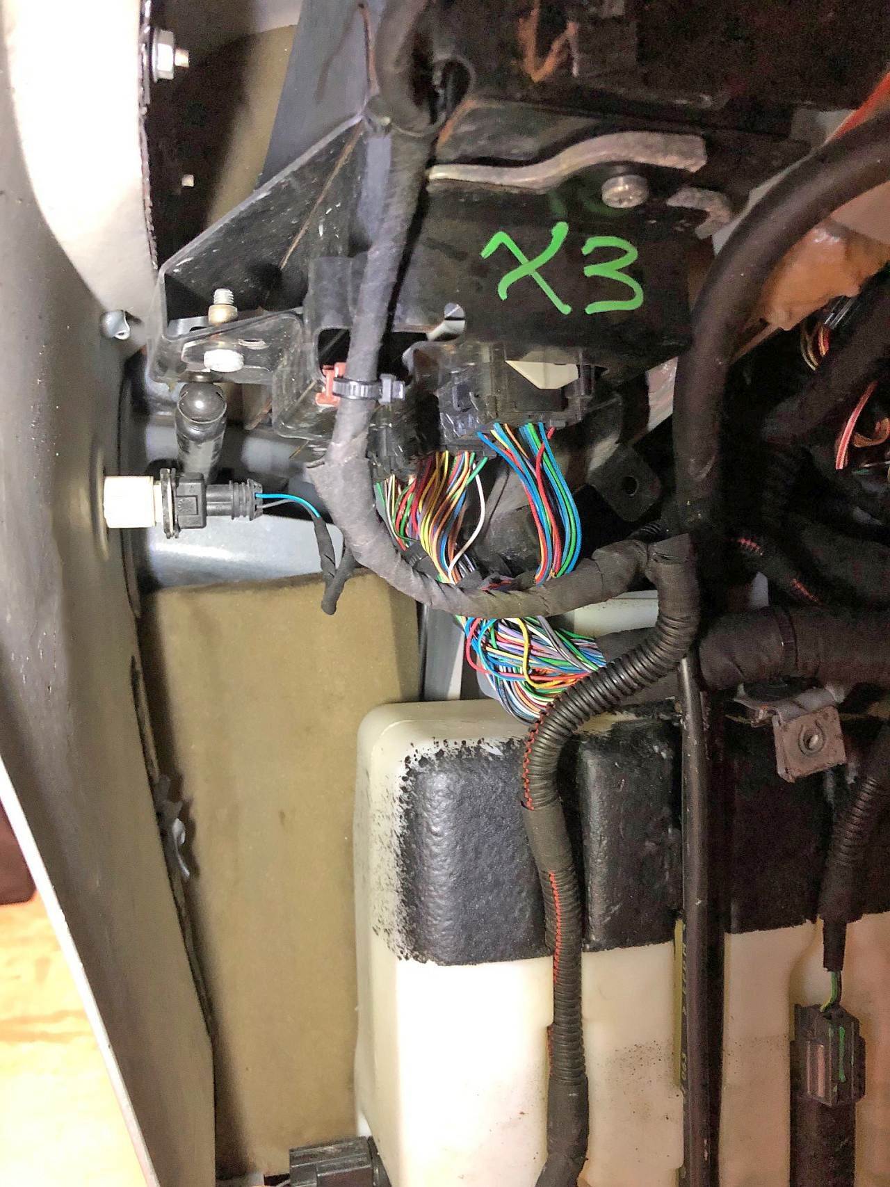

Very helpful - thanks. I actually ended up doing a web search for the part number and found a used one on eBay. It arrives tomorrow, and I'll get to test it If it doesn't work it looks like I now have a Plan C.

Replacement part arrived, and some initial testing suggests that it doesn't leak. Now I need to decide if I'm going to replace it myself or just wait until the timing cover leak fix and get it done at the same time.

Update... it turns out that the replacement reservoir also leaks. Naturally I only found out after it had been installed, and after my eBay return window closed.

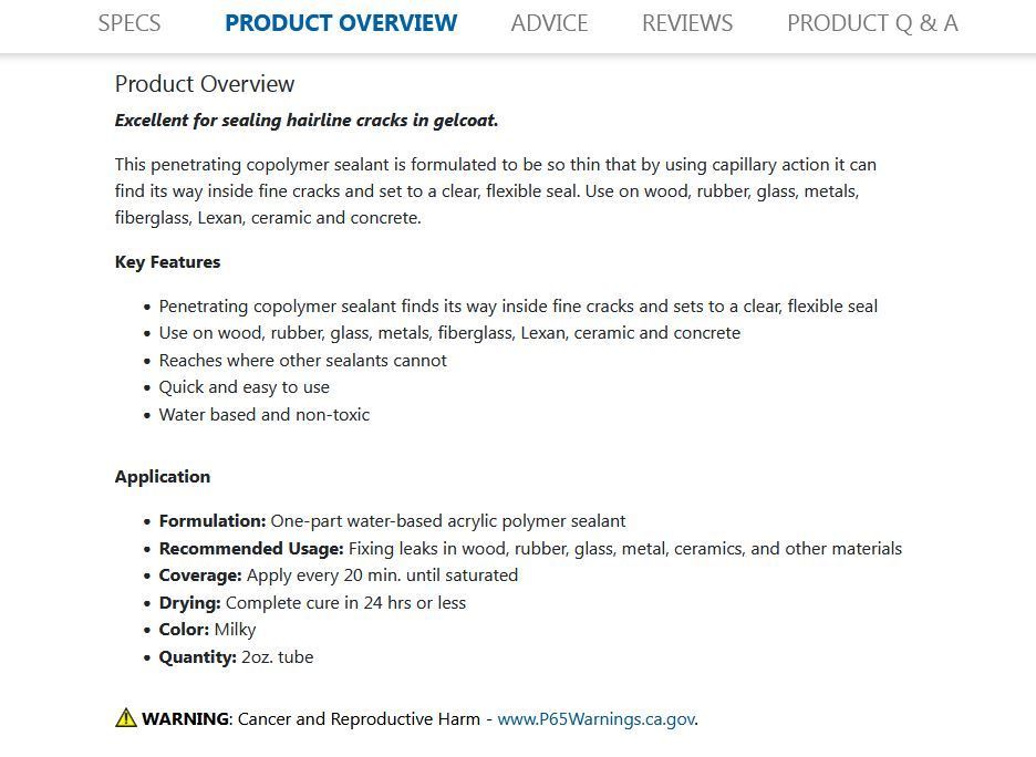

I saw this a while ago at West Marine when I had a series of spiderweb cracks in the deck fiberglass of my old boat. I wonder if it would be applicable to this problem?
