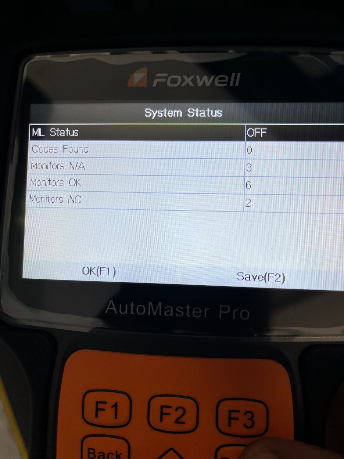

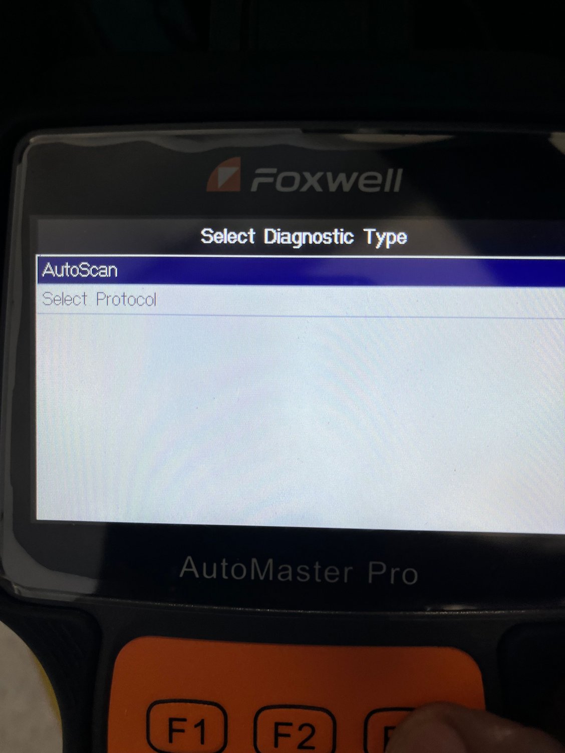

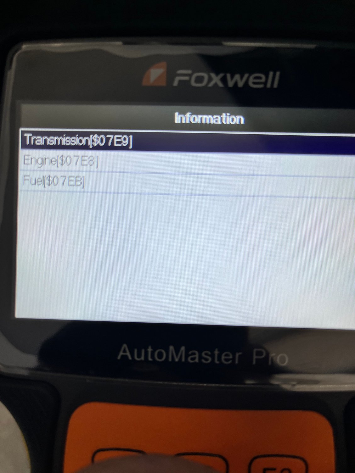

screenshots of my foxwell 680 reading my 2019 Vantage. Just hit OBDIII and it will take you into the 2019+ Vantage. When you select scan, you will see the foxwell checking the modules and the indicators on the dash will flicker and bells ring - normal during scan.. . You dont need to select any car... Selecting a MB car just brings you back to OBDIII.
