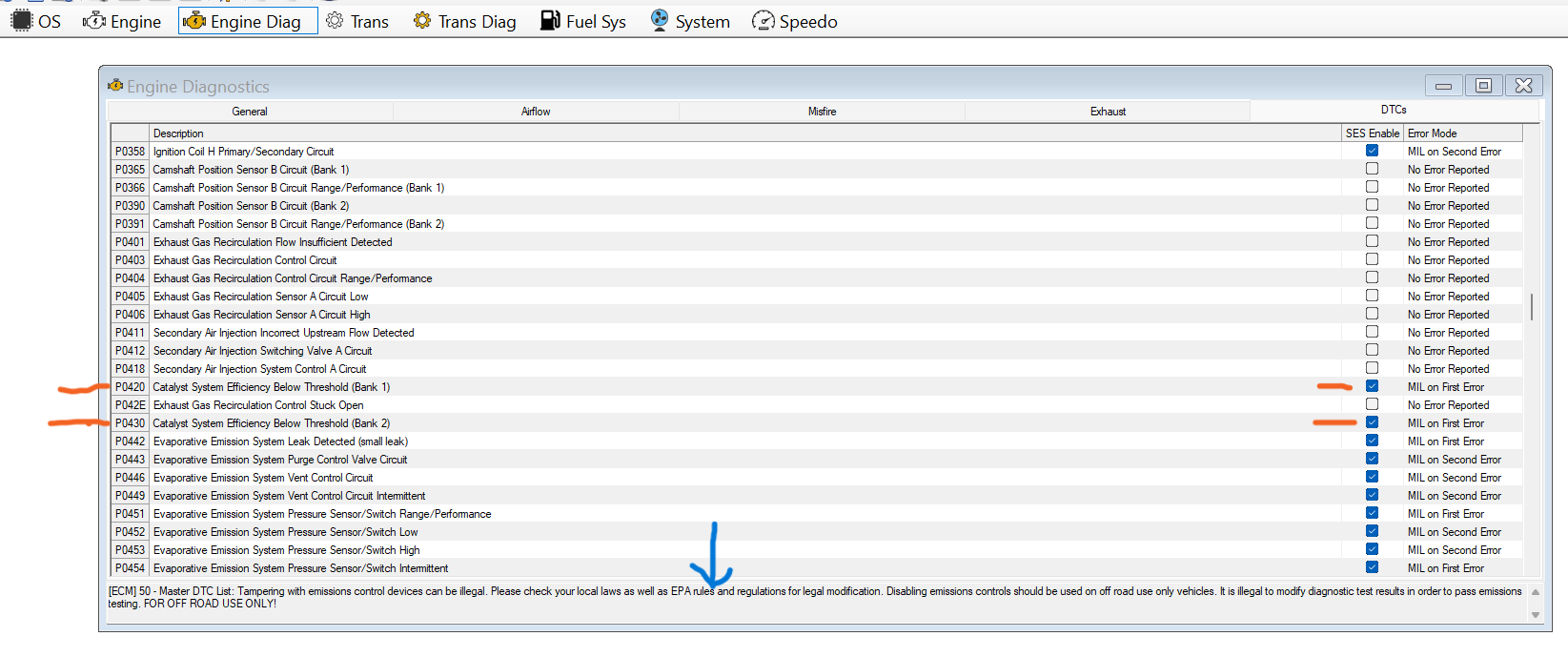

I've done a number of tunes with either catless pipes, headers or aftermarket CATS, that would leave a CEL (p0420 and P0430). I've "tuned out" the back O2 sensors and what the tuner does is redirect the ECU to no longer report the threshold failure even though the ECU still does its checking periodically (every 50/100 miles depending on that mfgr's EMS).
It's a simple "box uncheck" in the tune through a hack software. This is the one I use and what I do. BTW, you have to do it this way to preserve the startup diagnostics where the rear O2 sensors are checked as "present" and accepting and returning a voltage. Some mfgrs don't do a startup diag, most do.
ENGINE DIAGNOSTICS > DTCs > Uncheck boxes @ P0420 and P0430 (Note, even the hack SW now warns about modifying data tables BC the EPA is on a warpath now).
Also, this DEFINITELY will be caught now in a CA emissions check as since July 2021 they now check for a factory CVN that gets changed when the data tables are accessed and modified. The only way around it is if the tune (tuner) has submitted and received a CARB certification that delivers a CVN California will now accept. Some tune houses (very few) have submitted and received a CARB cert. Rumor has it CO now uses this check too but I cannot confirm that. This will only get more used, not less.
Here is an example of a failed CA emissions report BC of a tune:
