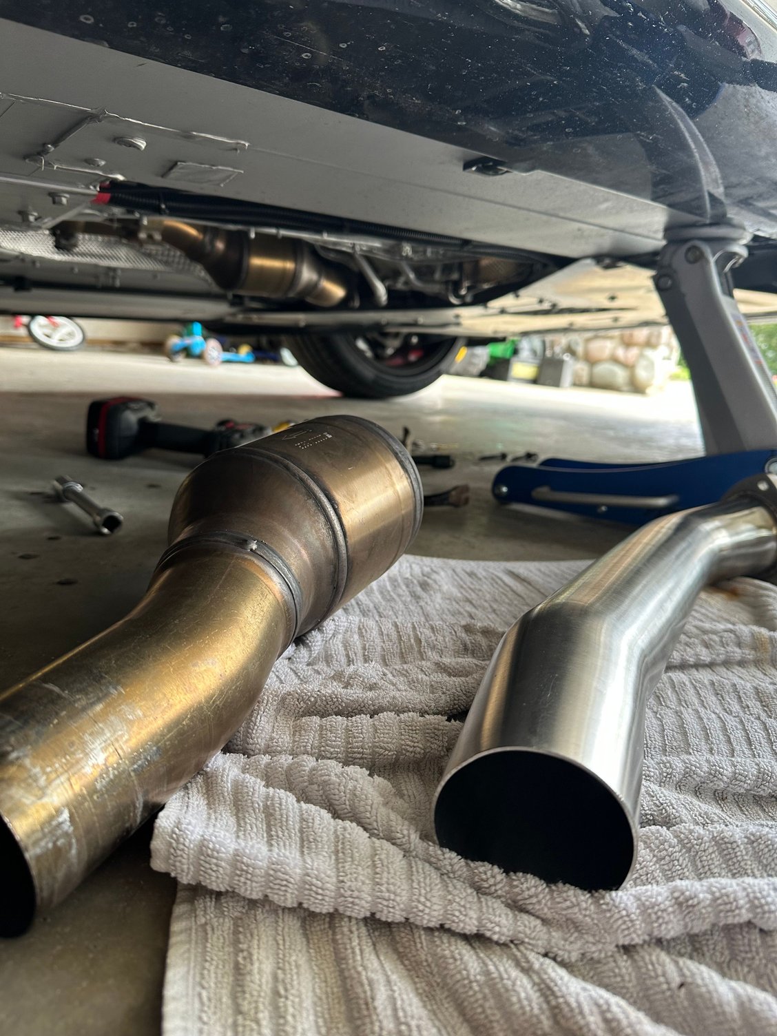

I put the cat deletes on today. Would be an easy job on the lift, but did suck doing under jack stands. 13mm and 15mm, wobble socket and extension for the top bolts. Velocity AP did include 3 bolts so I decided to air hammer out the top studs vs pry bar route I was worried might bend something. Highly suggest popping out the top studs, makes removal and install much easier. Also, don’t be an idiot like me and do this on your back with 18” of space. It’s a 1hr job on a lift.

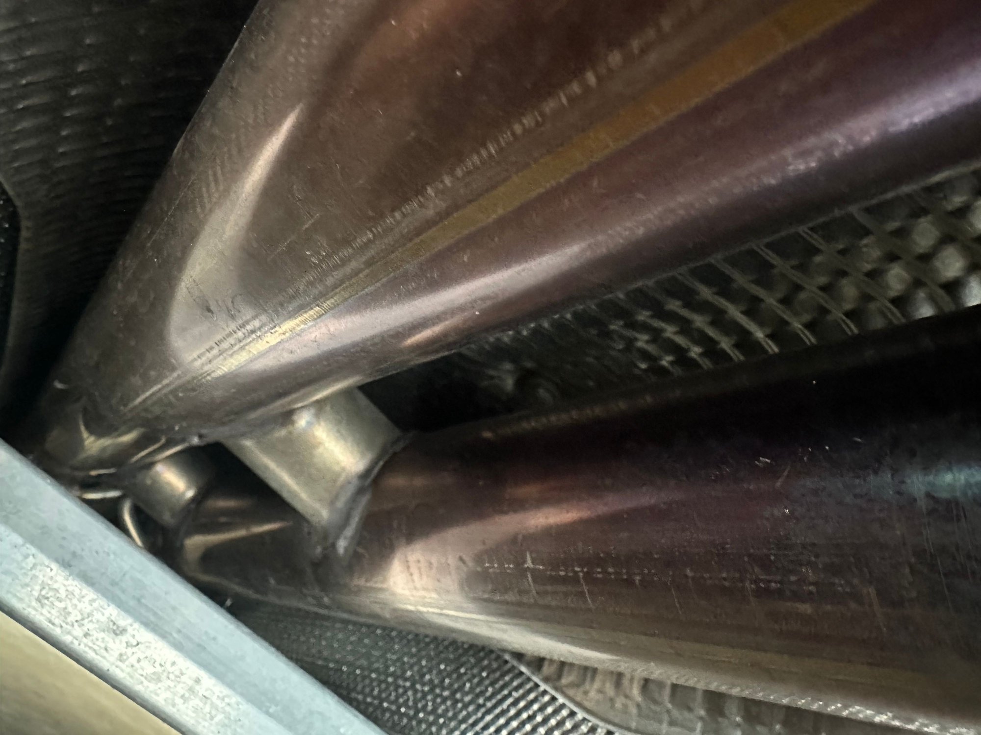

pretty cool to see the stock H pipe too!
Here’s a video with a few revs (in track mode). The car was already warm so this is not cold start.
2020 vantage with cat deletes
I only drove it 10 min. It’s noticeably louder but not transformative like the deletes on our cayenne gts was. I’m happy overall, plenty loud for the nature of this car. I think the pops and bangs are a little more aggressive now too. It can still cruise quietly in sport if you want it to. I’ll get to drive it an hour or so later tonight and let you know if I notice anything much more.

That was quick!!! How much louder what you say it is versus stock with the secondary cat delete?
